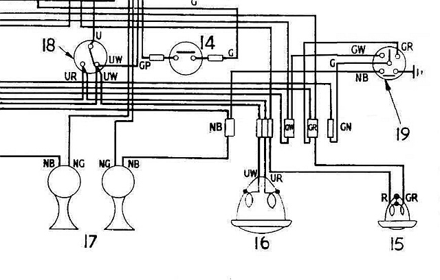

We're in the process of sorting out the wiring in our son's project 3A. In the diagram below, can someone explain why the G/N wire (see red arrow)is not connected to anything? Is this an error in the diagram? This diagram is from the owners manual.

No. It's designed like that to use the same wire harness on LHD or on RHD TRs. The diagram shows the circuit for a RHD TR. On your LHD TR, the un-used one shown in the workshop diagram is used to feed up the steering column to the chromed flasher clicker (or maybe it's used for the matching wire that comes from the flasher relay) - I can't remember.
Here's a diagram that has been doctored up for LHD connections.
