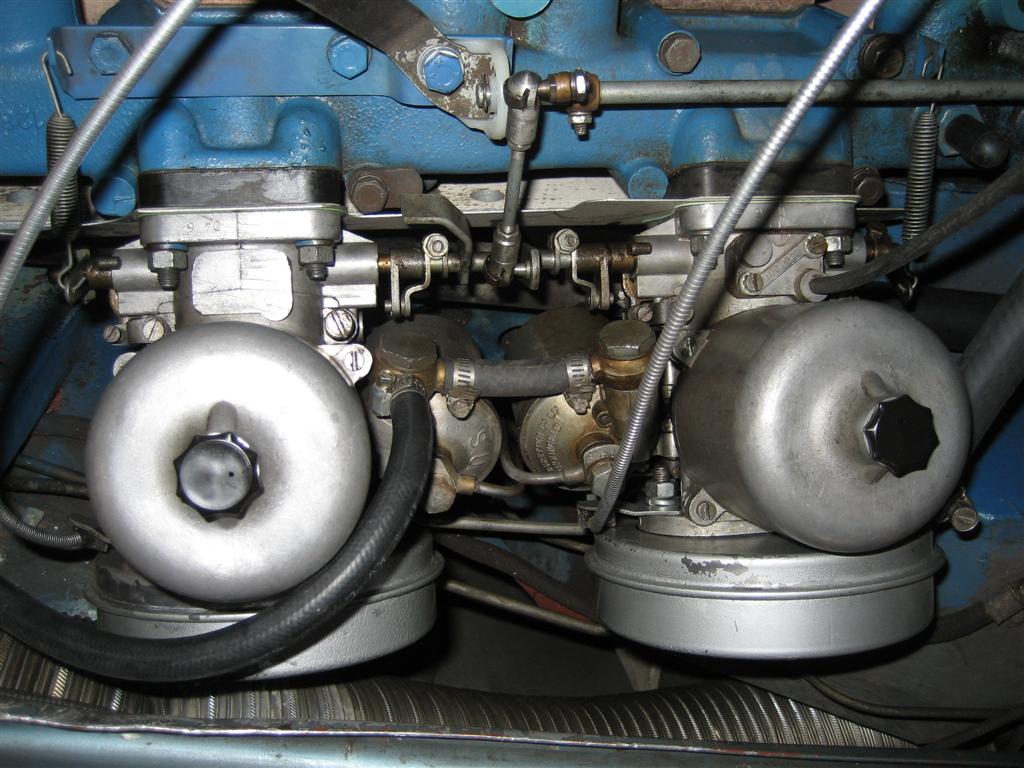

I think my air filters are original. Can you tell from the attached picture if they are original? (I can take a better one later...ignore the damper, its an old picture.)
Thanks!
-Brandon

Your air filters look like mine fron that angle. Mine are the original ones. The paint has flaked off of them some, just like mine.

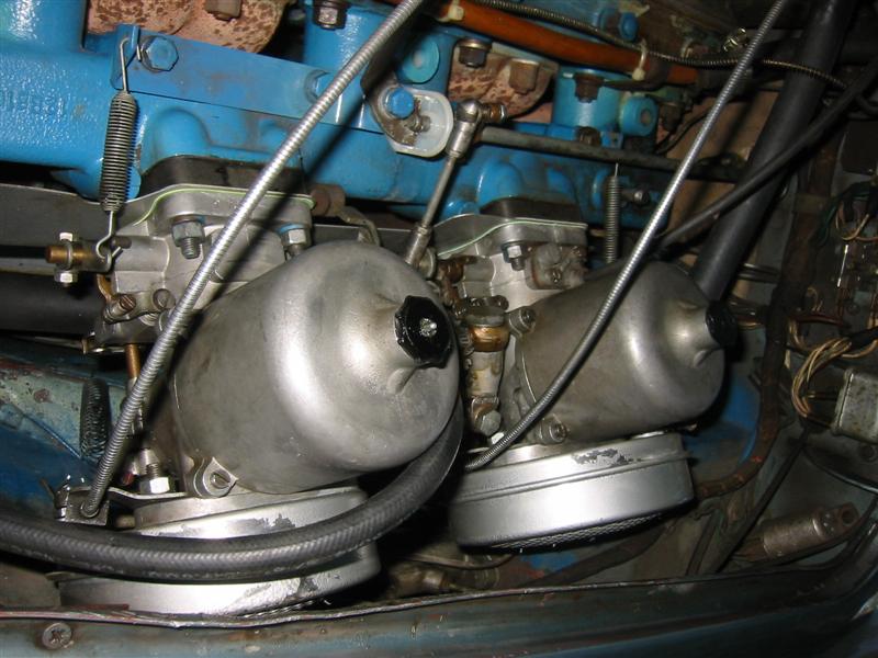

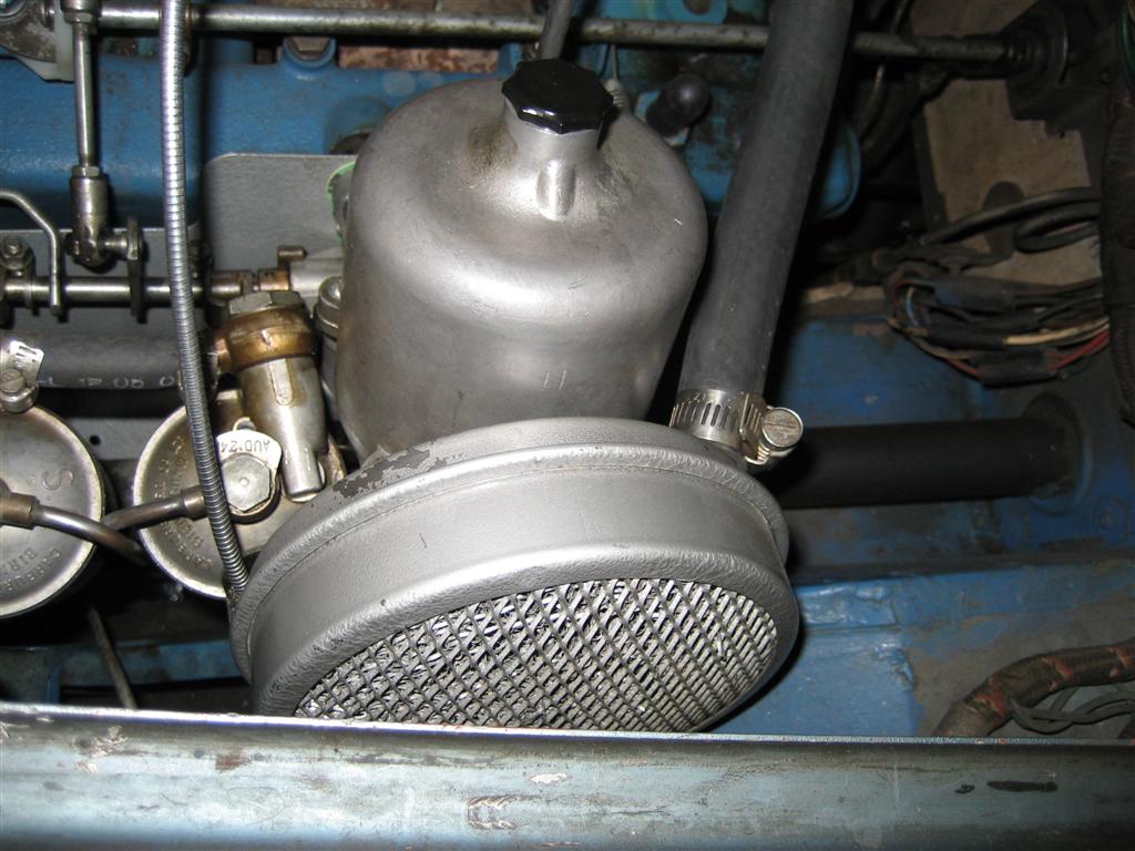

Here are two updated pictures. One of the air filter and one of the carbs.

Hi Brandon, from these pictures of your carbs it seems:
1. you have a persistent fuel leak from the rear carb
possibly both from the fuel bowl and the inlet banjo fitting.
2, the throttle shaft actuators seem to be too far out of alignment but that may be the picture angle.-?
-----------------------------Keoke
I'll check the fuel leak tonight, that could make sense. (What exhaust pipe does the rear carb correspond to when looking at the rear of the car?)

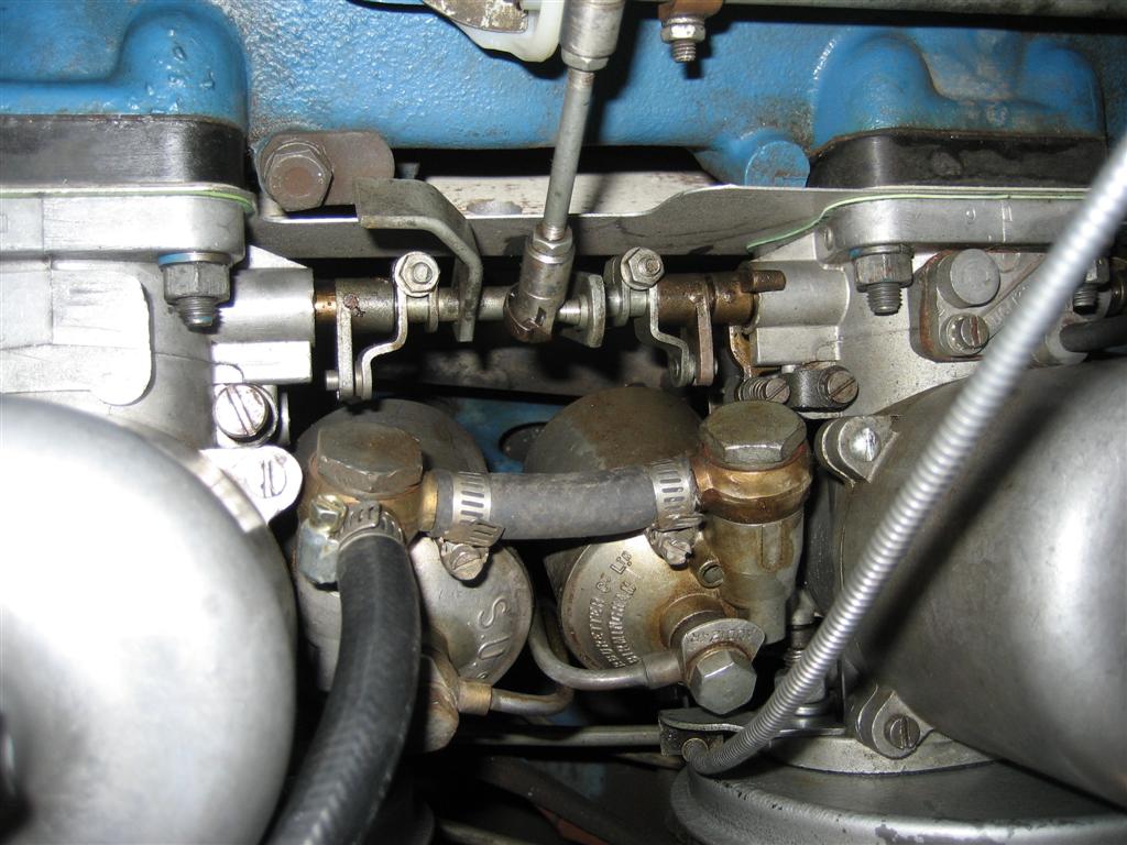

Here's another picture of the throttle shaft. How does it look from this angle?
It appears there may be a little difference in the angle of the throttle forks. Is the space (gap) the same on the two forks? When you pull the throttle do both engage at the same time?

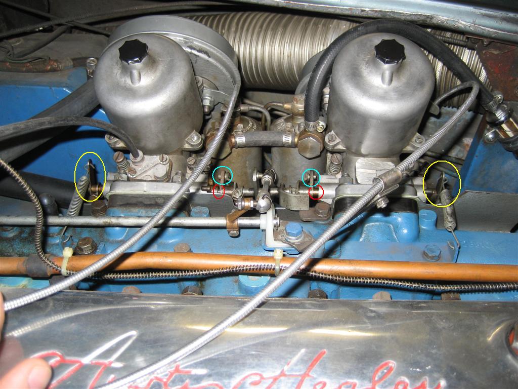

Nice observation TH. I've taken another picture and made a few marks on it.
In red, I circled the gaps. The gap of the front (right) carb is greater than the rear carb.
In blue, the angle between the two are different. The front carb's is at less of an angle (more vertical).
The same is true with the yellow circles, however the difference in angles are a bit more dramatic.
However, when I pull on the throttle, everything seems to engage at the same time.
-Brandon: new picture confirms suspicion.
Pulling on he throttle and everything seems to engage at the same time, does not assert that the butterflies in both carbs are at the same position which they must be at for the carbs to operate correctly. However, it is possible that if the carbs were rebuilt the shafts were drilled incorrectly. Consequently, it is necessary to determine that the butterflies are at the same position and move in synchronism.---Keoke
Keoke's got it. Pull the air cleaner off and look inside to see if the butterflies are both closed completely. Then pull on the throttle and see if they open at the same time.
