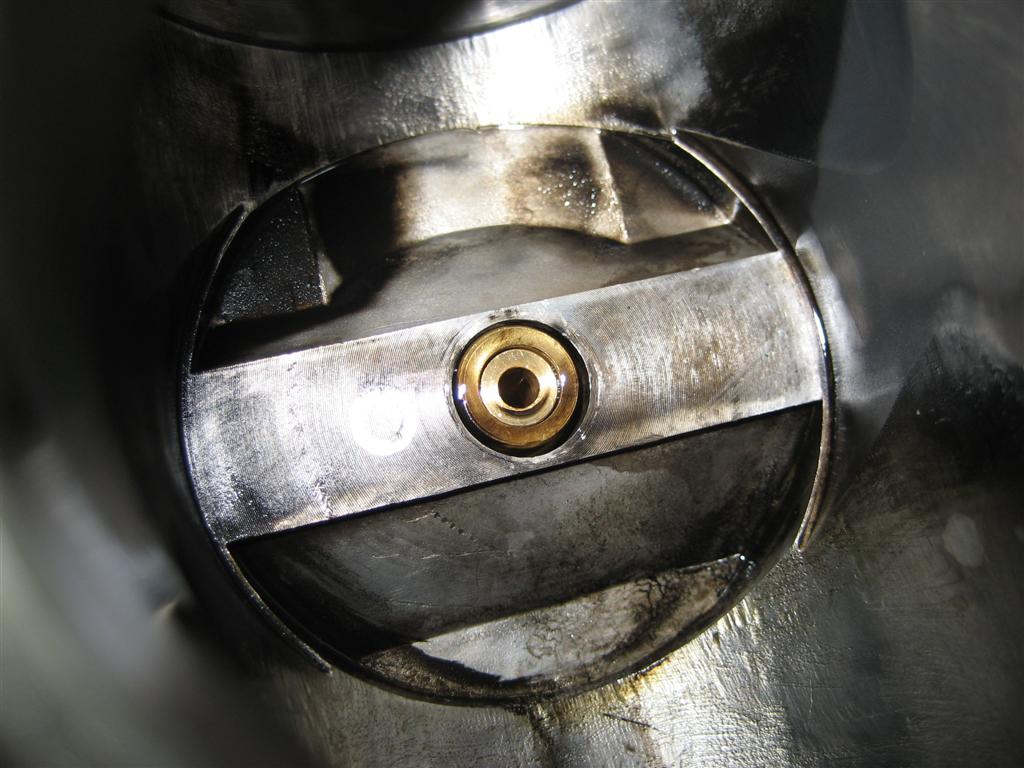

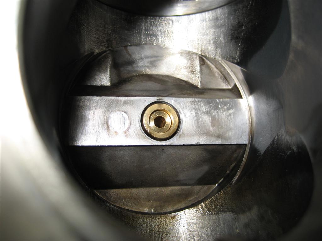

The butterflies are both closed completely and they open together. I've attached a picture of each closed just to make sure I'm not missing anything.

OK Brandon, looks pretty good. Except the butterfly in the rear carb may have been buggered upon installation. See the little wrinkle in it on the right hand side close to it's shaft. Further, baring a bad shadow the upper left hand edge appears to be unsymmetrical and may be leaking air.--Keoke
I zoomed in on it and it does look like there is a small gap in the upper left hand edge. Is there any way to fix this or is it that big of a deal where I would notice a difference?
Yep Brandon,Send the carbs to Joe Cutro for a proper rebuild. I also forgot to tell you, as I looked at the inboard side of the front carb's shaft the gland is missing.---Fwiw---Keoke

I think Keoke is right, the rear butterfly valve is not seating properly.
You don't need to have the carbs rebuilt to fix this, all you need to do is to remove the carburettor and then loosen the two fixing screws (just loosen them, don't take them out) and then seat the butterfly flap in the fully closed position, then tighten the screws down.
This is a very common "PO" mistake with HD carbs... the butterflys have to be able to close fully otherwise the slow idle will never work correctly. With other carbs like HS or H carbs, this doesn't matter so much (because slow idle runs through the main throat on those carbs).
If you want and you are feeling up to it, I'd also get the teflon bushes from David Nock and put them on the carb throttle shaft while the carb is out of the car. If you do this be sure to get new butterfly flap screws (62 on the moss page) as well, as you will have to remove them to remove the shaft. Removing the shaft is pretty easy, as long as you have a small punch to drive out the little pins that hold the levers on the throttle shafts.

Alan - Do you think that small gap would be causing my problems? I'm in the process of ordering the parts so we'll see in a few weeks, but I wasn't sure if that would cause my issues.

Regarding the gap on the butterfly flap - absolutely - getting rid of this is critical for good running for an HD carb. If there is a gap, you will never be able to properly synch the carbs at slow idle and the only cheap and easy solution is Keoke's /bcforum/images/%%GRAEMLIN_URL%%/crazy.gif ...
