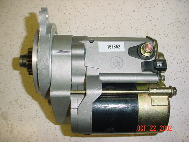

The aftermarket starters such as this one from APT have multiple mounting holes for the starter nose clocking. See attached pics.
