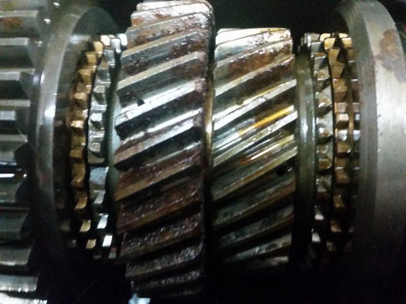

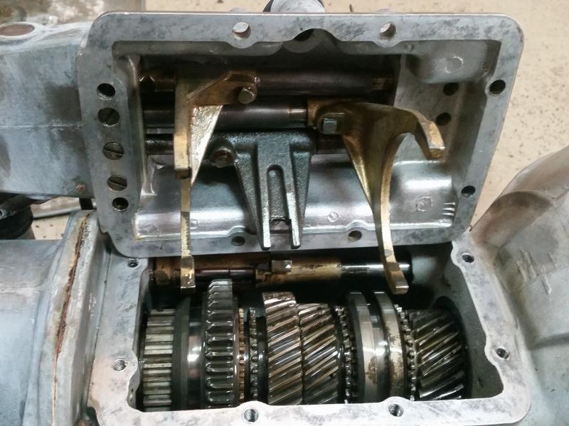

I know what the synchronizer gear looks like but and know what the word means but haven't a clue how it functions. Pics before I cleaned them up.
16113428_10212207599724821_716130653087317359_o.jpg16251861_10212207595804723_8417931776424453062_o.jpg
CJD
You have the correct TR3 box with the non-synchronized 1st gear. That means it will grind if you push the clutch and rapidly shift straight to 1st. If you quickly shift to another gear before selecting 1st, then you will not get the grind.
The 2nd pic shows what looks like a good bit of surface rust on the gears themselves. If that is what it is, vs. just old greasy looking oil, then I agree with Randall. It would be best to rebuild the countershaft with new bearings. The bearings will become sticky from the old grungy oil, and then they will slide rather than roll...resulting in a countershaft failure.
Edit...Doe...scratch that. Your box has a broken dog tooth on the second gear, visible in pic 2. You will need a non-optional rebuild, as you have no idea what that dog tooth did as it circulated through the box.

As I am sitting here studying your pictures...Your 1st gear is also shot. The edge that mates with the 1st/rev idler gear is worn way back at a steep angle...indicating that the gears are not meshing well at all, and have not for some time to get that wear pattern. Sorry to bear the bad news, but that box has seen better days. It very well may be more cost effective to find a donor box to swap the internals, assuming you want to keep the original case. If not a complete new box may be a better starting point.

"Your 1st gear is also shot. The edge that mates with the 1st/rev idler gear is worn way back at a steep angle...indicating that the gears are not meshing well at all"
And I was thinking that was normal by design. I guess that happens when you don't know what to look for.

As far as your question about gear condition, yes, I would expect several gear issues to show up as you rebuild . Second gear, 1st gear, the synchro rings, 1st/reverse slider gear, the countershaft, and all bearings will need to go as a minimum. When you have a box with mechanical damage like yours, it is usually much cheaper to start with a donor box where all the gears are decent. Then all you need to worry about are seals and bearings.
