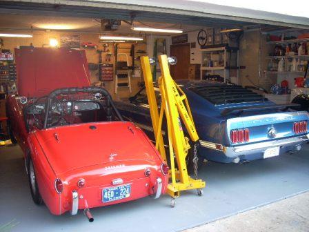

I went to my buddy's machine shop to make a tool, but the machines are set up for a job he is doing. I'll have to wait a week. In the meantime I looked more carefully at the crank throws and its not good. The combination of oil, antifreeze and water wetter have turned beautifully polished crank throws into something resembling the grooves on a 45. (ancient music storage device). So on my way home I picked up a cherry picker and am now in the process of clearing some space in the spare bedroom to store car parts.

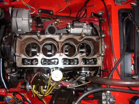

My brother came over to give me a hard time. and with a little chiding...THEY'RE OUT!!!

The bearings took the brunt of the abuse. The center journals are still perfect. Number 1 and 4 show a very slight scratch. I think at this point a set of bearings from BPNW will do fine. Since I couldn't on a lathe or mill to make a tool, I drifted the liners out. The process caused a small amount of chipping at the bottom of the liners. They are .040 over and a bit thin at the bottom. It looks like I can remove 1 or 2 hundred thousandths from the bottom of the liner to clean up the damage and still be able to reuse the liners. I cannot believe that little bit of shortening would cause piston binding (l over d). Also, I removed the lifters, the cam is fine but 1 of the new lifters obviously was not hard enough, starting to mushroom. also a couple of others were not rotating. I think some of these aftermarket lifters are of dubious construction/quality.
