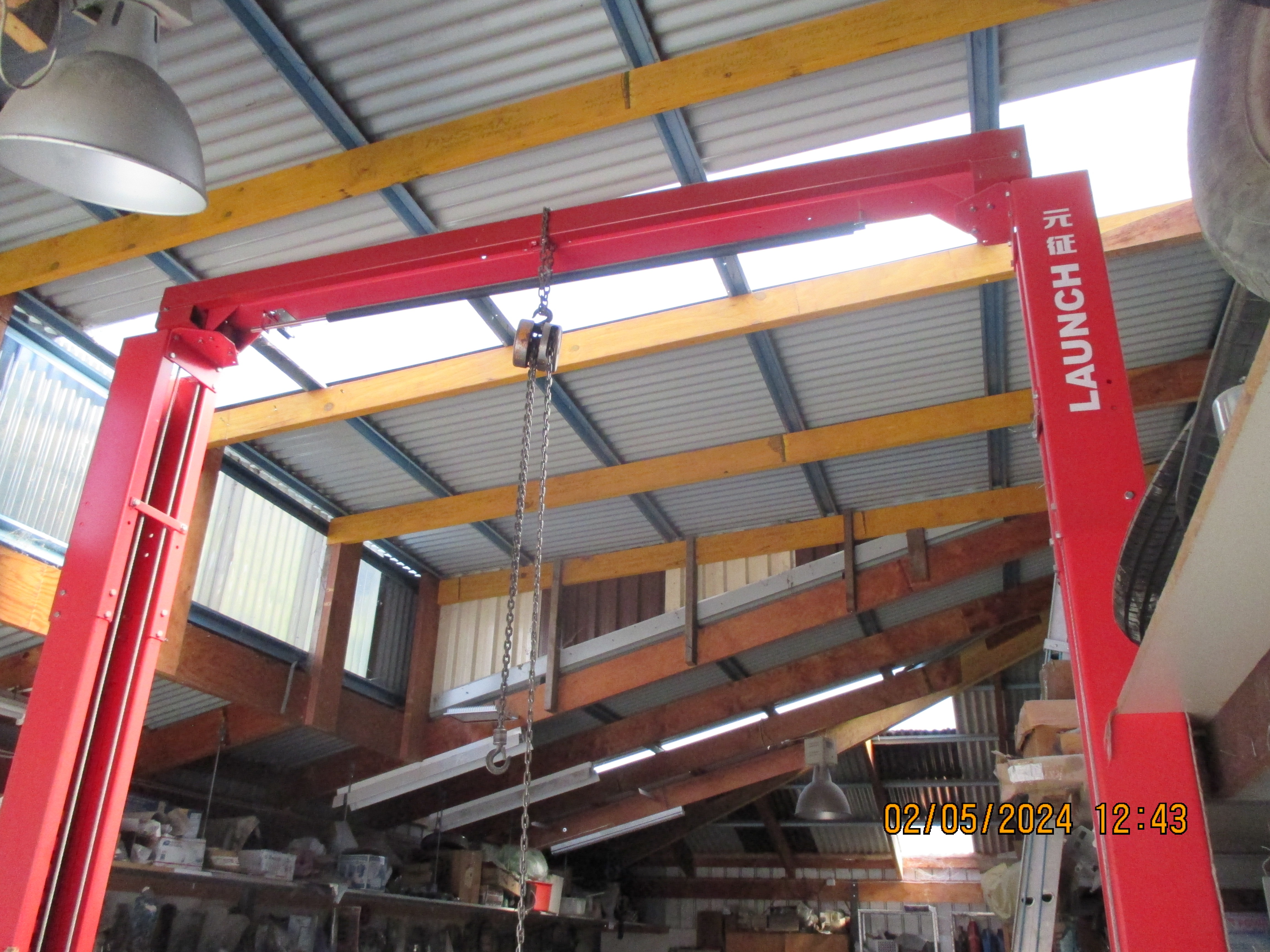

Toby...you may be interested in this.
I fitted a RHS steel beam across the top of my 2 post hoist and have an attachment for a block and tackle.
Great for lifting engines etc....Also for lifting bodies on/off chassis.
Great idea that! Could have used this quite a few times already!
The normal lifting arms don't actually raise that high up (since the car obviously sits on top of them), so lifting from higher up would be very useful.
