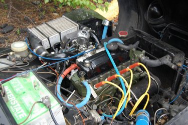

There was a gent there (Jim Danielson) from Nebraska who has a Metro turbo on his Sprite/Bugeye that he bought in England on a vacation. He said that the intake manifold needs some massaging for hood clearance at least with the bugeye bonnet he's fitted, might clear ok on a box Sprite. Here's a photo that Gryf Ketcherside took of that installation.

Nope, I wasn't at Lake of O. Heck, I'm lucky if I have time to make it to the Annual British Field Meet here in my hometown of Portland, OR each year! It's supposed to be the biggest brit-car swap meet west of the Mississippi or something like that. That's a nice lookin' car though! I like the way he managed to get an intercooler in there. From what I can see, I'm going to have to put a blister above the carb. It's either that or some people said to shave the manifold mating surfaces at an angle of a few degrees so that it tilts down slightly. Personally, I think a blister giving a hint of what might lurk beneath will be cool, but then it's obvious that I'm not too concerned about the "stock" (HAHA) appearance of my car!
