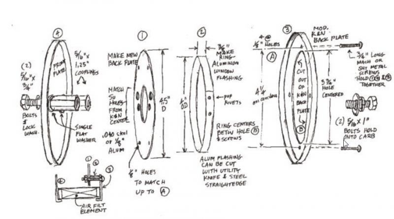

I used coupling nuts inside my K&Ns in combination with 5/16" allen screws inserted from the carb flange side:
https://www.healey6.com/Technical/Werner/Installing K.pdf
Great idea, think I ll make up some threaded bushes thanks no more juggling and dropped nuts !!!!
