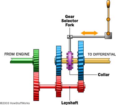

But still there is no need for even that on any gearbox, whether dogbox (syncho-less, or standard). You probably are familiar with the way a gear box works, but I'll explain anyway. There is the input shaft (coming from the engine), the layshaft, and output shaft (going to the differential). There are gears on all three shafts (only 1 gear on the input), but they are only permantently connected to the input and layshafts. The ones of the layshaft can spin at the speed of the input when in neutral. The way gears are selected is that the shifter fork moves a cog gear, which engages into the side of the gears on the input shaft. While the gears on the input aren't solid against the shaft, the cog gear is and will turn at whatever speed the engine is turning. So when you go to upshift, you will already be rolling (meaning the layshaft and input gears will be spinning, from the engine), and the wheels will already be turning over (the cog gear will be spinning), so both are turning, and both will engage at a low gear speed, which is what you want because of the lower gear ratio. Double clutching would be pointless on an upshift, as it would speed up the cog gear needlessly, and actually put more strain on the synchros to slow it back down again. For a picture (which always helps me understand stuff), check out my attachment.

Have you ever driven a synchroless gearbox? I have one in my binder. I don't use the clutch after I am rolling, but I can assure you of this. If you do use the clutch to either upshift or down shift you need to double clutch to have a decent shift. Why you need to do this is when you push in the clutch and pull the tranny out of gear you wait untill it easily falls out of gear, i.e. the RPMs of the input gears, and those of the cog gear will be matched. At this point you can not put the tranny into the next gear because the revs of the input gears are too low to match up to those of the cog gear, so it would just grind if you tried to. So you release the clutch to allow the input gears to go back to the engine RPMs. You then push the clutch back in and put a light pressure on the shifter allowing the gears to rub very slightly, then when the RPMs of the input gears drop to the RPMs of the cog gear your slight pressure drops you into your next gear. Its easier and quicker to just shift without a clutch, hence the reason, my father, grandfather, and most of the other old truckers I used to know refused to use a clutch.

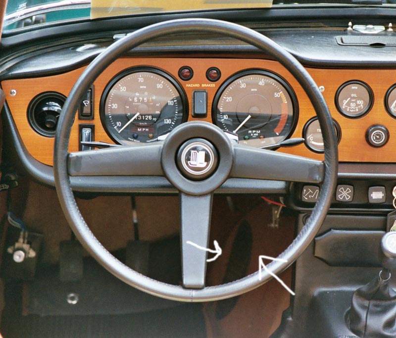

A member of my club has this TR250, and I noticed something down in the footwell that he seems to have added for the purpose of heel and toeing: a large notch taken out of the transmission tunnel. See the attachment for a picture.
