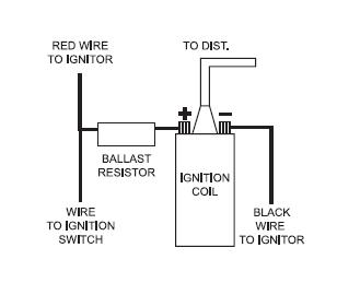

A 73 TR6 would have a resistor wire incorporated in the harness wire to the coil. Is your Pertronix wired so the red wire gets a full 12v instead of from the resistor wire? And do you have the proper "external ballast required" coil, or the resistor bypassed for the coil?
If the wiring is right, then trying a "known good" coil would be a good next step, IMO.
As long as he's getting at least 8 volts from the ballast resistor wire, he won't really need to bypass the resistor wire with the pertronix red wire.
I really believe that those instructions and ilustration are not TR6 specific.
Will check my wiring in the morning... if I need to get a new coil what do I need to know since it has the ballast wire in the harness. Can I pick one up at my FLAPS?
edit: will also check the voltage to the coil as well.
Sometimes a PO will have changed the wiring to the coil to bypass the ballast resistor wire. So what you need to do is verify that you have the original 2 conjoined wires going to the coil. They will exit the harness behind the alternator and connect to the spade on the + terminal of the coil.
The wire with the braided cloth sheath will be the ballast resistor wire that supplies between 9 and 10 volts to the coil when the key is in the "ON" position. The other wire supplies 12 volts to the coil only when the starter is engaged. At least that's the way it's supposed to be.
If you have that set up and want a replacement coil for testing, get one with a 1.5 or 1.6 ohm resistance.
You may have to get the male spade connectors to put on the coil. A lot of times there are just threaded terminals with nuts for eyelets, but spade adaptors are available..Try NAPA if nowhere else.
