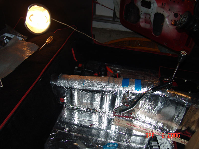

I am using second skin. It is like dyno mat. I placed it just about everywhere carpet is going to be. So I'm sure the heat issue from the exhaust should be helped.

How do you like it so far? I thought it was super easy to install. The only bad part was the thick aluminum backing did slice and dice my fingers!

I LOVE the stuff. It is real easy to cut, work with, and install. You bet, cutting hands up a little is definitely part of the installation.
I was unsure of buying 40 yards and glad that I did. I have a few spots to do and will send Jack what I have left. It will all be used!
