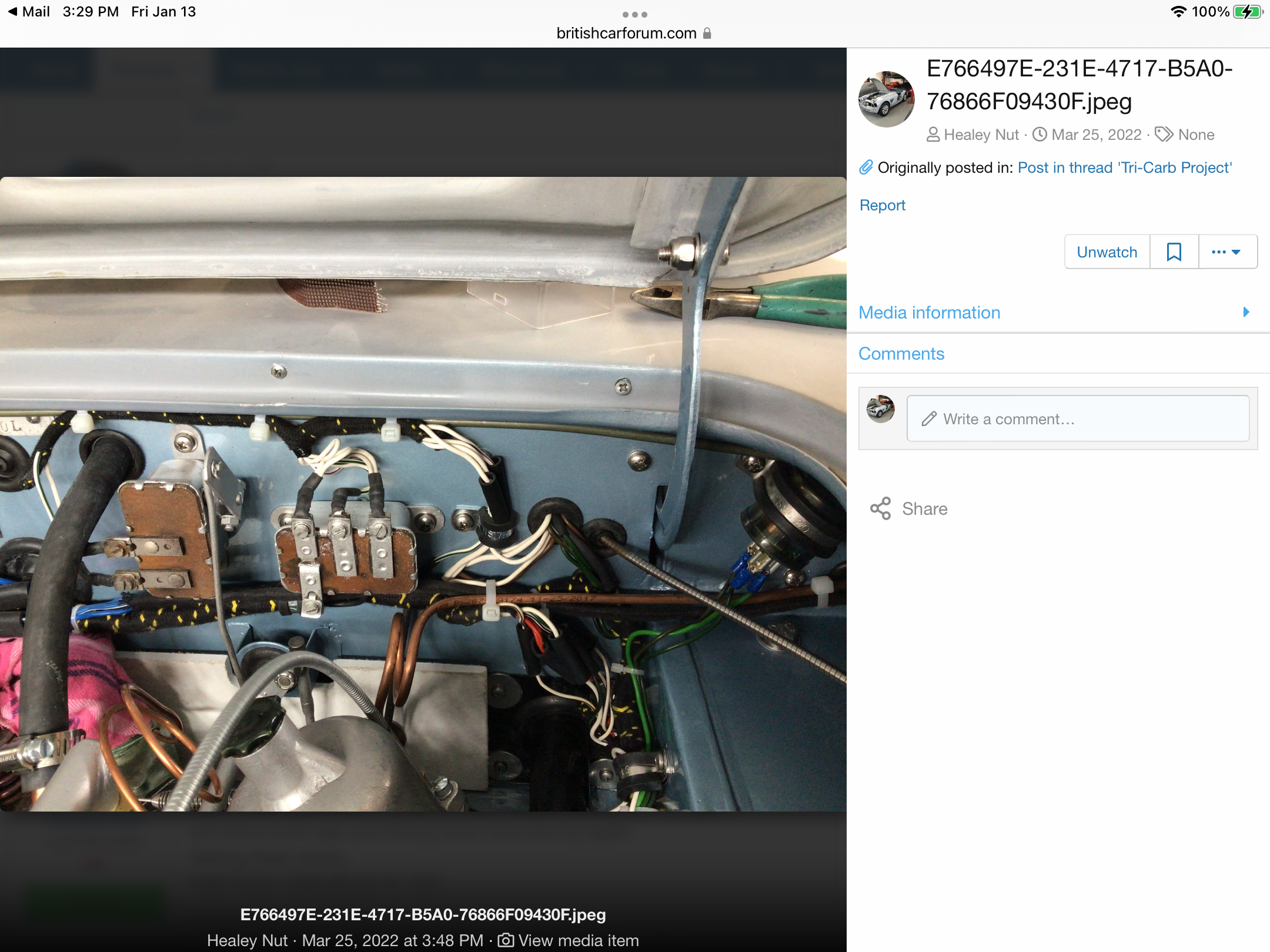

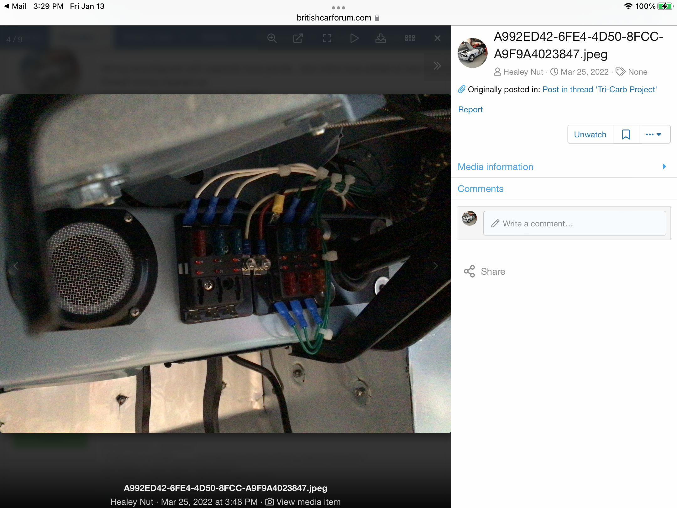

You need to rewire the car for better protection from a wiring harness fire. See pics.
Couple of hours work once you have the parts, cleaner firewall, better protection, easier troubleshooting, and room for accessories to be added. Cost is maybe $30 tops, and that's a whole lot cheaper than replacing a wiring harness or worse, and don’t forget an in-line fuse carrier in the boot for the licence plate lamp in case you get rear ended and it shorts out the wiring.

BigMac--
Do yourself a favor and take HN's advice. There is nothing good about an inoperative or burned Healey!
Very cool!what kind of parts list am I looking at here?
One in line fuse holder for licence plate lamp($3ish) , 2 multi fuse blocks (Amazon about 20$ ) some wire and selection of fuses to suit the fuse blocks
