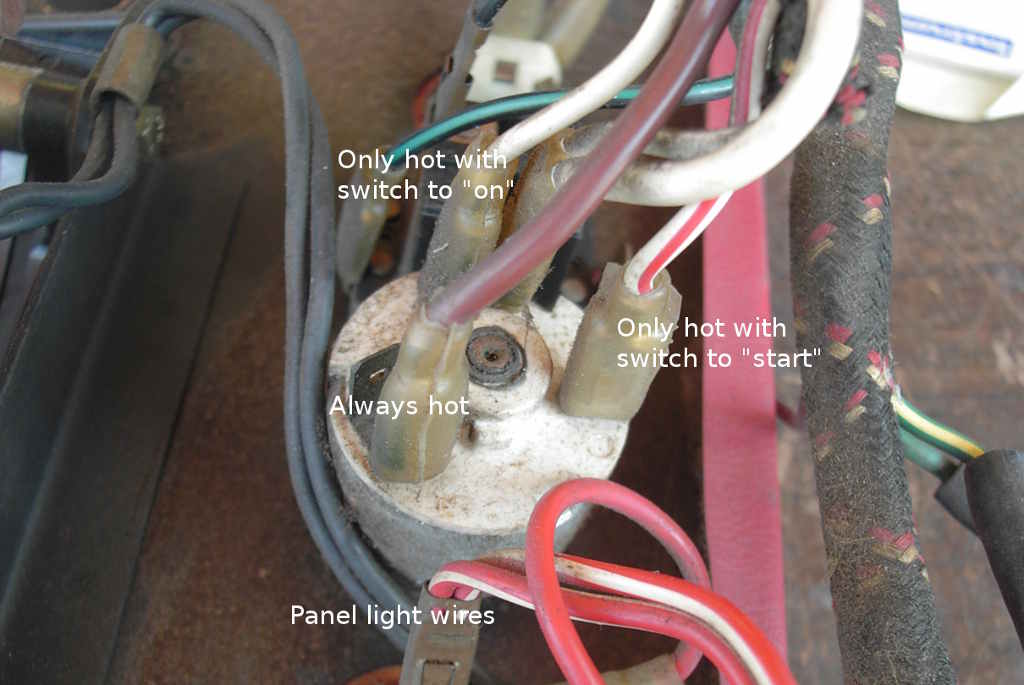

I'd check the connections at the back of the ignition switch (yeah, I know it's a pain) Main ones to be concerned with are the red/white wire and the brown wire. Be aware that the brown wire is always hot and unfused, so disconnect the battery before rooting around too much. If those wires have good contact, you should put an ohm meter on the switch. The brown wire connector is power feed to the switch. The red/white wire is the trigger wire to the starter solenoid.

The testing Greg suggested is a resistance test using an ohm meter. An open connection has infinite ohms (the needle doesn't move) A good connection has no resistance (zero ohms) and pins the needle at zero. So with the battery disconnected, you are checking for continuity (zero ohms) at each connection from the key to the starter with the key in the on position. Does the BJ8 have a starter button like our older Healeys? If so, the button has to be depressed to get a continuous connection to the starter. If not the key has to be turned to the starter position for this test. The two test leads are placed on each side of the connection (the black or red leads can be used in any order, they are not positive or negative in the ohm testing.)

Since getting to the back of the ignition switch is such a pain, here is another test you can do. Pull the white/red wire (I called it red/white incorrectly in my last post) off the starter solenoid. Attach a volt meter on that wire and to ground. If your car is still positive ground, use the black lead on the volt meter for the white/red wire. Turn the key to start (with battery connected) and see if you get 12 volts. If you get voltage with the key on, you probably need a new solenoid. Try cleaning the contacts first though. If you don't get voltage, the white/red wire may have a bad connection at the ignition switch or a bad switch itself.

I'm not sure what you mean by solid readings? With a voltmeter you should get the following with one lead of the voltmeter attached to the chassis (red for + ground, black for - ground)
Key off
12v on brown only
Key on
12v on brown and white wires
Key to start
12v on brown, white and white/red
Donovan2001 said:
However, when I test the red/white wire going into the solenoid I pick up NO ready.
Where are you testing a red/white wire? There are red/white wires right next to the ignition switch, but they are for the panel lights. They have nothing to do with the starter circuit. I hope I didn't confuse you with my first post, I'll try to change that for future readers.
Donovan2001 said:
I know the solenoid is good but still unsure if the switch is bad. Now, when I turn the key I do get a light on the tachometer, so I still think the switch is good.
Until the above tests are done (and a couple more depending on the results :wink: ) , it could be a bad wire connection, a (partially) bad ignition switch or a (partially) bad starter solenoid.
Donovan2001 said:
Should I go to the fuse box next?
no
Donovan2001 said:
Having some troubles ready the Haynes book :smile:
No surprise there, you might want to pick up the shop manual. I made a wiring diagram for the late BJ8s. It used to be here on BCF but that section of the forum is no more, haven't figured out how to get a PDF into the wiki. Anyway, I can email you the diagram if you PM me your address, or you can download an older copy from HERE

That initially sounds like a bad wire, but I'd suggest checking it again when you know you have a good ground since all of your readings are low. Try this, check for voltage on the battery side of the starter solenoid, that will be the most reliable source. Once you see 12v there, check the other connections.

The voltage readings suggest the battery is discharged or defective.---Keoke
Connect battery directly to a good chassis ground bolt (if your car is still positive ground, connect positive cable to chassis, otherwise negative). Bypass kill switch. But if battery voltage is only 10.25 at the terminals, it is no good, or badly run down. Trickle charge for 36 hours and check again. Should be 12.7-12.8 volts if fully charged.
