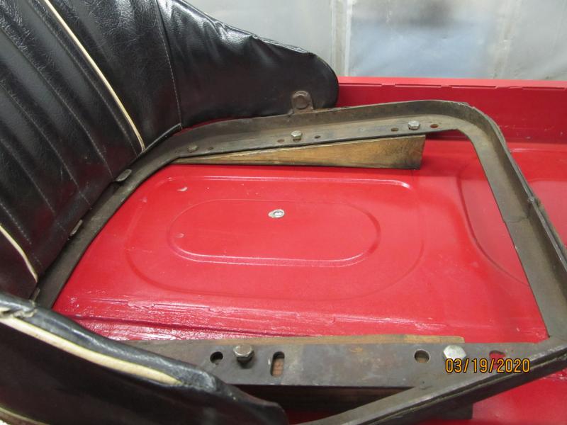

But the modification that helped my driving comfort the most was removing the seat adjusters to keep the whole seat as low as possible (no one but me drives it, so don't need adjustment) and mounting wood wedges where the adjusters would go. This raises the front edge a little more than 2" and reclines the upper seat back over 4". This makes a slightly reclined driving position much like an easy-chair and gives an additional 4+" of arm room so the steering wheel feels much more comfortable.
