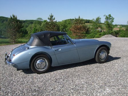

Derek,
1979 Ford Thunderbird. These are all the same paint.

Because of the fine metallic in the Healey blue you will be hard pressed to get a match. Even the same can of paint shot on a different day may not work. Air pressure. temp all have an effect on how the paint lays down. It will just look different.
