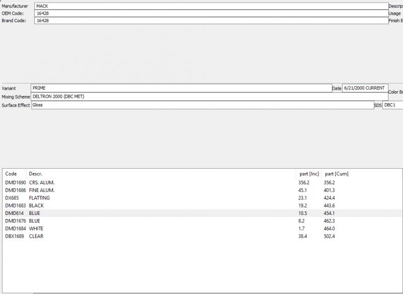

Here is the paint mix for a pint of Rick's color...PPG 1648 … and, yes, it says it's a Mack color.

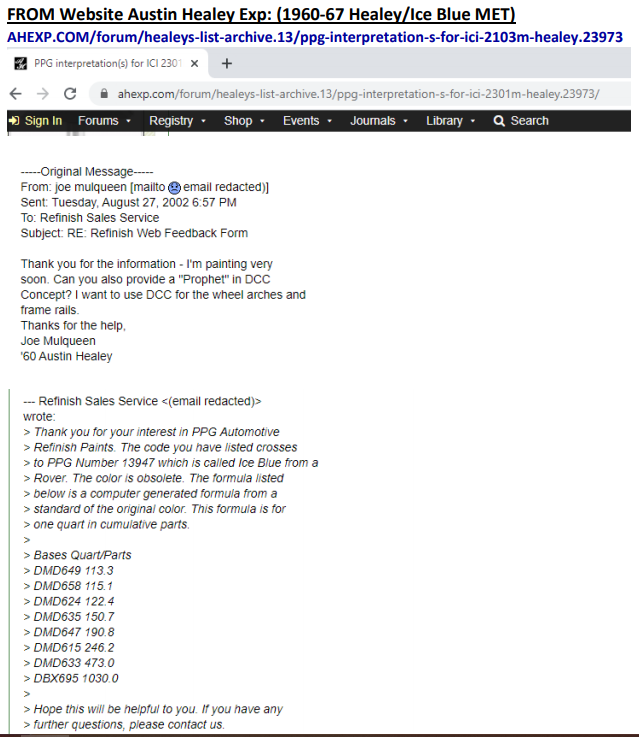

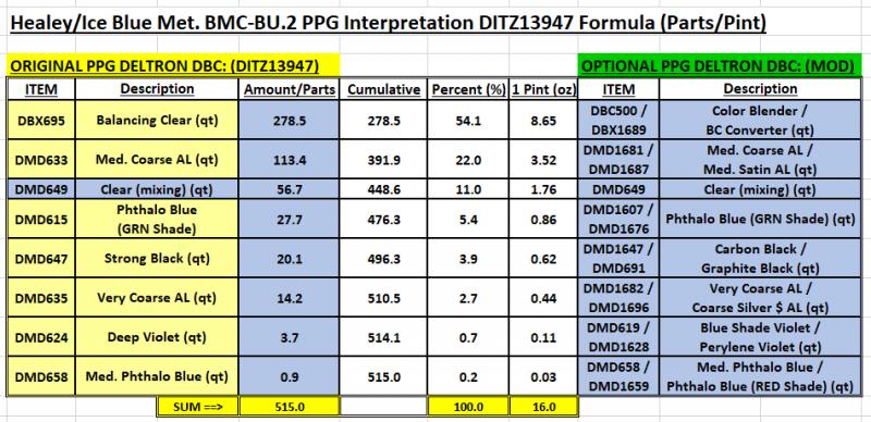

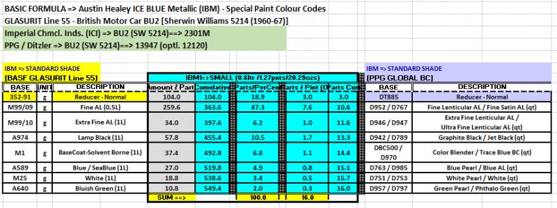

Austin Healey BU.2 Ice Blue Metallic (1960-67) BASF and PPG interpretations in BASF Glasurit Line55, PPG Global (BC) and PPG Deltron (DBC) formulas ... see attached files ... Flypast111
  • Austin Healey Blue MET. ICE BLU ICI2301M DITZ13947 PPG Formula 1960-67 PartV.jpg

  • Healey BU2 Ice Blue Met. PPG Formula Interpretation DBC Deltron DITZ13947.jpg

It's interesting to note they say this formulation is a cross-reference to "Ice Blue" from a Rover. Rover did not combine with Austin until 1967, after Healey production had ceased. No where can I find an image of a Rover sedan that was painted Ice Blue until one for Australia late in the '70s. The bottom line is I don't know there is any modern color formula that you can get that will be an accurate reproduction of what the cars looked like when new, just something that looks pretty close and probably more glossy with bigger metallic flakes. Or as the saying goes, "Healey Blue is in the eye of the behlolder."
