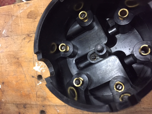

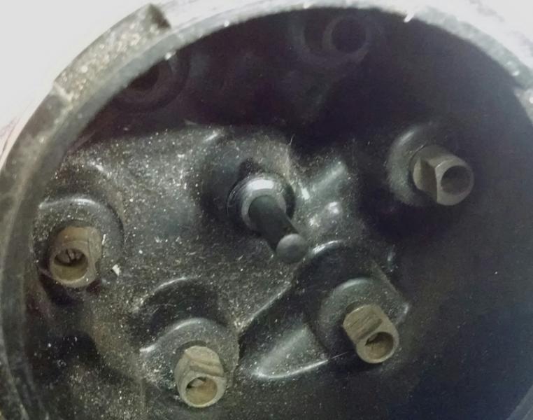

I have a standard Lucas OEM cap - the coil lead screw is under the carbon post. Couldn't get a pic of it, but it's there:
Re: Healey 3000 Distributer Cap

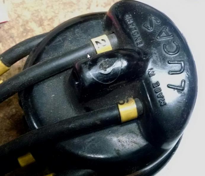

Here is a picture of the Lucas cap sold by Moss--the screw is not under the center conductor.
That looks like a good idea. I stand corrected for the BJ8s if not for the earlier models. Maybe the change was made between the DM6 and 25D distributors.
Does the cap have the Lucas imprint on the top?
I had three side-entry caps. All identical in terms of the necessity of removing the carbon bit to reach the screw. I replaced the cap when I bought the car about five years ago without incident, though I was unfamiliar with side-entry caps and the screws. It was almost surely a Moss cap. The next two were also Moss caps. All three caps developed spider cracks on the inside, likely due to my efforts to remove the carbon bit. I think slapping them on the bench, as suggested by one forum respondent, is fatal to the integrity of the caps. When the cap is struck on a flat surface, I believe the force accelerates the brass bits cast inside the cap and creates spider cracks. I just ruined a newly delivered Moss cap in this manner. For whatever reason, I have to remove a bit of plastic from the notch where the fender-side cap attachment spring fits. I've had to do this on all of the caps I've owned to get that spring engaged. So, I did this with the new cap and somehow managed to push the carbon bit into its hole without noticing I had done that. I then probably caused many spider cracks inside the cap by tapping it on the bench. I won't do this on the next cap, and I intend to buy a backup cap from the UK source Steve G mentioned in response to my jabber. I did solve the carbon bit removal task, suction, etc., having failed. I identified a number drill, 7 or 8, as I recall that just fits the carbon bit hole. Holding it by hand and pressing it on the tip of the carbon bit, I trimmed out just enough material to free the carbon bit. Alas, I had already damaged the cap. This all came about as I was installing Lucas ignition wire set. Noting you are in Cleveland, I bought my first Austin Healey from a U of Cincinnati law student living in Cleveland Heights in the summer of 1963. I was at that time working as a reporter on the Painesville Telegraph. I'm from Norwalk, and my best friend was a classmate of the guy I bough the Healey from and had actually ridden in it in Cincinnati. The car was set up for drag racing, with a toggle for the overdrive on the shift lever and cutouts on the exhaust pipes ahead of the muffler. A pregnant wife spelled forced me to sell the Healey while I was working for a newspaper in Dayton. Like so many old guys, I had to relive the early car experience by buying another Healey.
Steve, yes, it looks as of the cap was redesigned for the later cars. It says Lucas Made in England on it.
