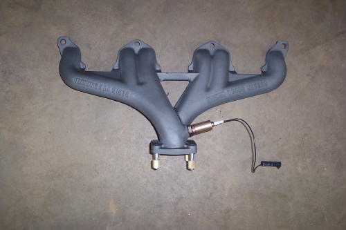

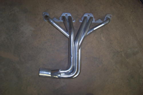

My local powder coater is now doing high heat coatings on exhaust manifolds and headers. I had it done on my exhaust header and on an unused header I plan to sell. It looks good, and was pretty cheap. You might check with powder coaters in your area.
David- Are they using ceramics?. There is a difference.
I'm really not sure. The coating on the header looks just like the jet-hot coating I had on a small block Chevy header. I think it was ceramic.
It is coated inside and out, and the exhaust manifold has held up well so far.
