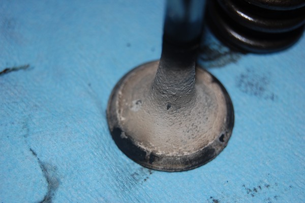

I've attached a picture of one of the valves.
