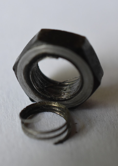

Head reinstalled yesterday, Permatex copper "Spray-a-Gasket" on the REAL gasket. Thought about filling coolant but decided to do the valve lash first. All went well until the number two exhaust. As I tightened its lock-nut it felt "soft." Then recalled one of them having been an "iffy" snug-down in the past. This time it became plain which one that was. Now waiting for a replacement for the adjusting screw and nut. Glad not to have poured the coolant into the engine, as it may take relieving the head bolts and nuts holding the rocker shaft. But I think I can "cheat" it, recall doing similar in the past.

Got the replacements, not pleased with the quality of the jamb nuts. 5/16-24 but "wobbly" on the screw threads. Have put a standard 5/16" NF on the screw and set lash. Want to change oil & filter before firing it up.
The 60-year-old jamb nut and its remains found wrapped into the screw:
LarryK
Got tired after 60 yrs, not bad.

billspohn
Did you check the condition of the bushes in your pedestals? It's amazing how many times that is ignored and people wonder why they can't get repeatable clearances and find out that the rockers are wobbling with worn bushes and worn shaft - I guess because the rockers shaft comes off as an assembly there is a tendency to assume it is OK (and it usually isn't).
Too bad about the locknut! That is usually over tightening in the past. The threading on the adjusting screws isn't a wear item so the fact that the new nuts are loose on them is another offshore parts absurdity. And at $1.69 for new screws, I wouldn't take replacement screws seriously either.
Platinum
Did check rocker bushings and shaft, well inside acceptable tolerances. I've seen many so worn the bushings were ovaled and the shaft dig into by more than a few thou.
The original nut felt "iffy" as I recall, when last I ran the clearances. Still waiting for the good ones to arrive, the loose-fitting ones are already in the File 13 As for the $1.69 screws, not gonna use 'em. if I still had easy access to Rockwell testing I'd file a flat in one and test it just for S&G.

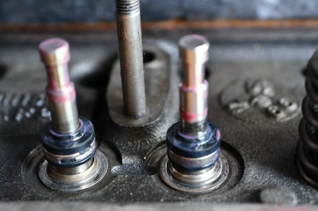

Another thing done while into the head refresh was to replace the silly O-ring "seals" (all but two were M.I.A. anyway) with these:
