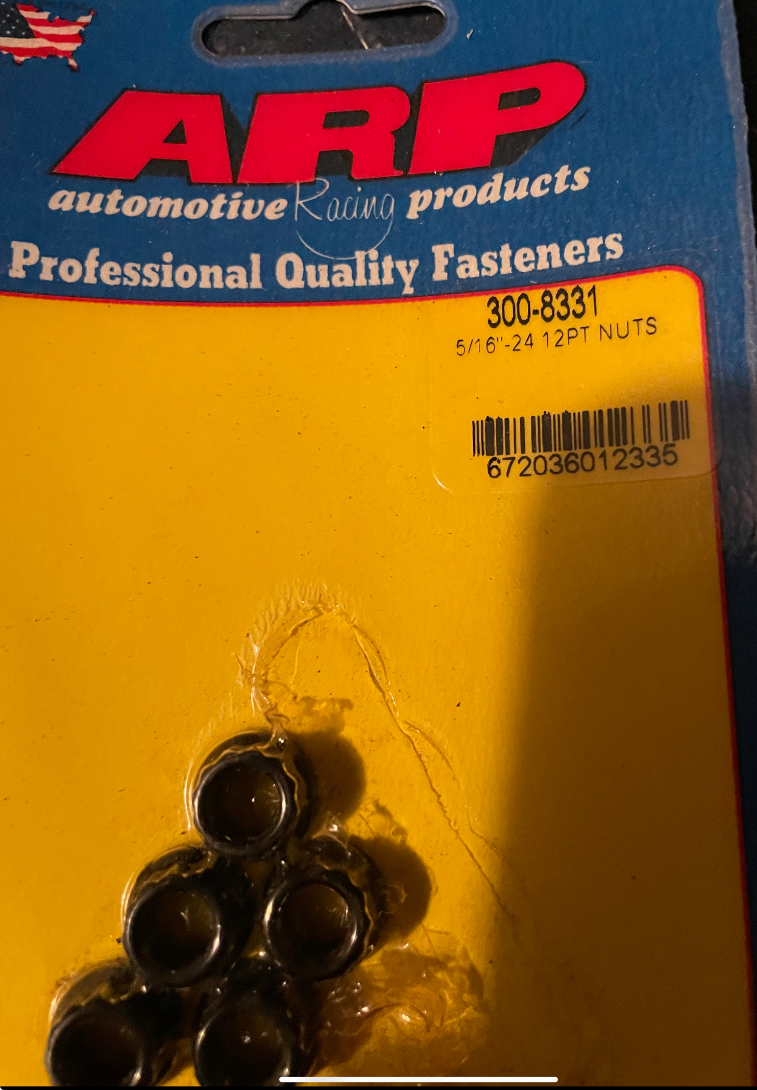

Oh man, I just started this same carb removal and ran into the same problem, thus consulted this forum. I too was hoping to read about the 'miracle cure'. I'll try your suggestions - shorter wrenches, grinding down the outer edges, bending the handle, etc. If the "OD" of the box end of a wrench is ground down, will that enable it to fit between the nut and the carb body? (Is that what bdcvg is suggesting?) And the 12 pt / jet / ARP nuts sound like the way to go for reassembly - looks like a special wrench is needed for those 12 pt nuts because they don't have flat faces - more like a star nut?
Nothing special other than a 1/4” ratchet, elbow and the correct 12 pt socket size. I think I used a short 3” extension too.
Thanks. I was thinking that a socket and ratchet wouldn't fit in the space, but that will be great if it does.

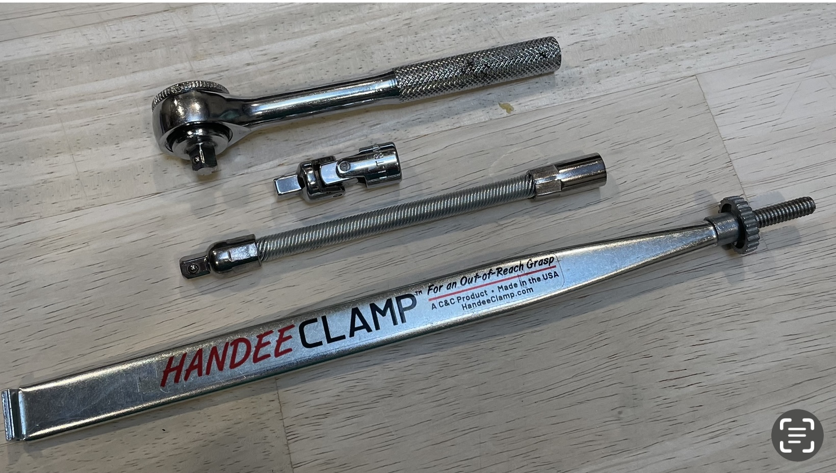

I use this setup for the bottom carb bolts on my BJ8 plus the appropriate size socket. The HANDEE CLAMP comes in real handy holding nuts in position too.
