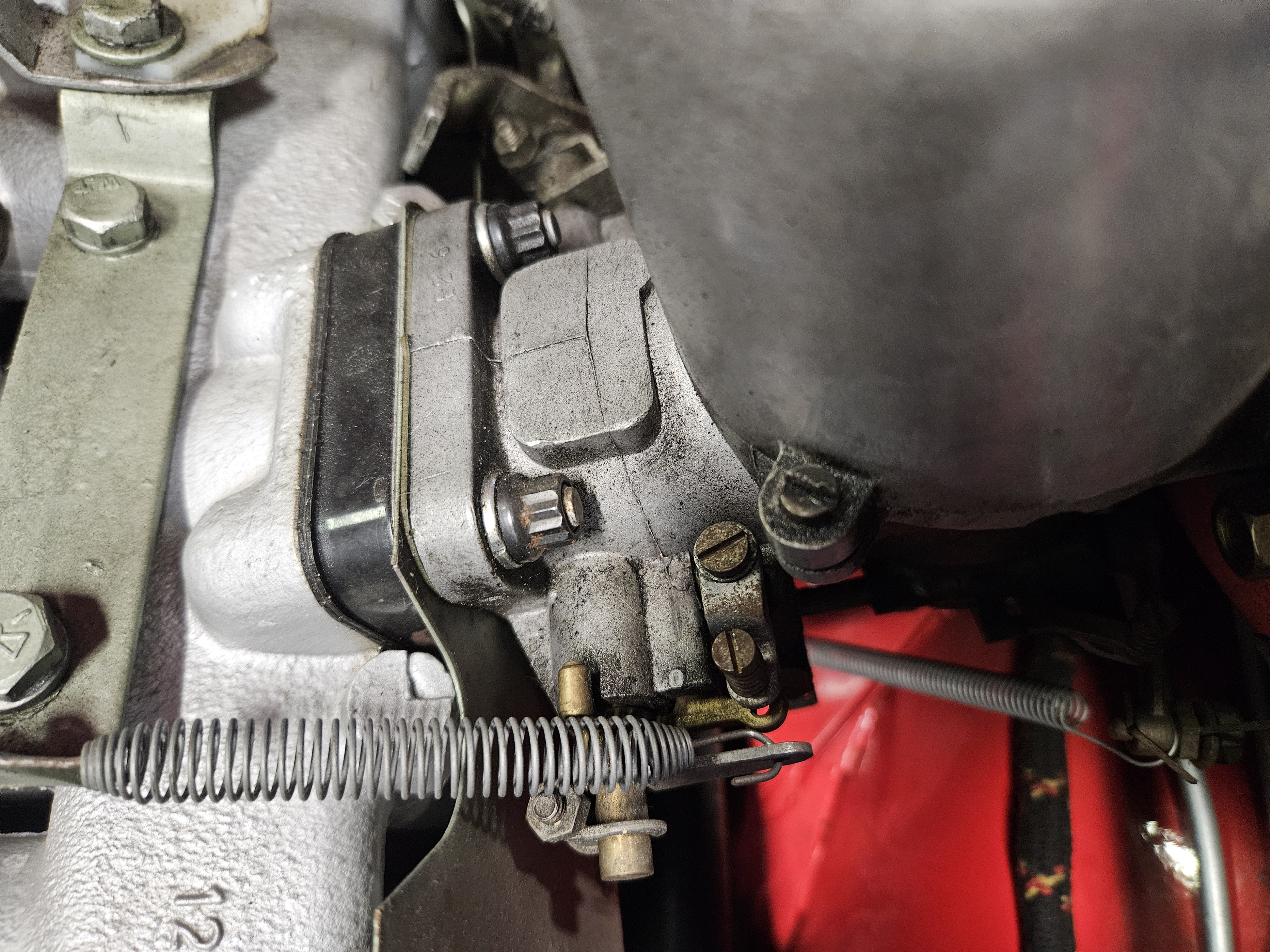

I use this setup for the bottom carb bolts on my BJ8 plus the appropriate size socket. The HANDEE CLAMP comes in real handy holding nuts in position too.
