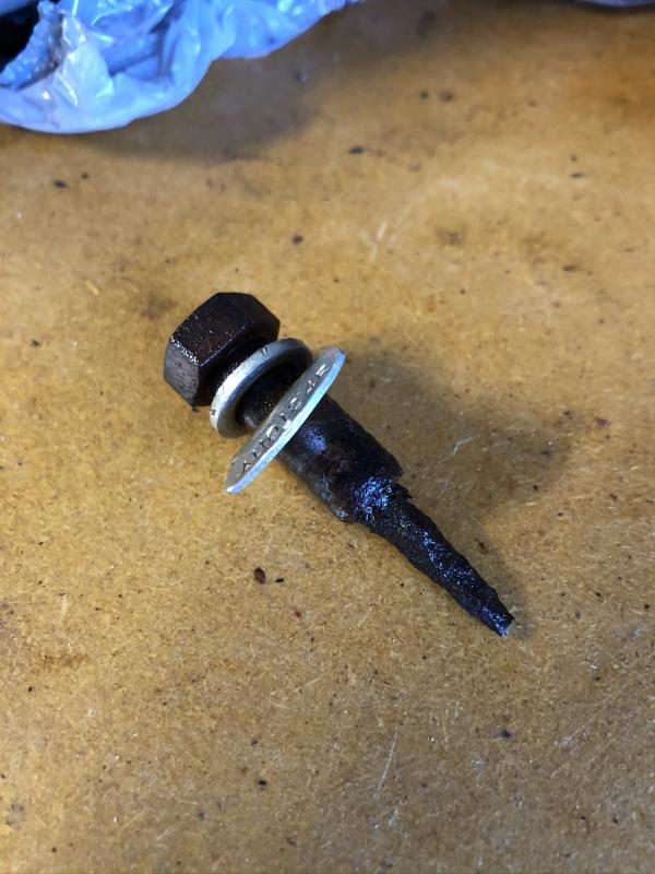

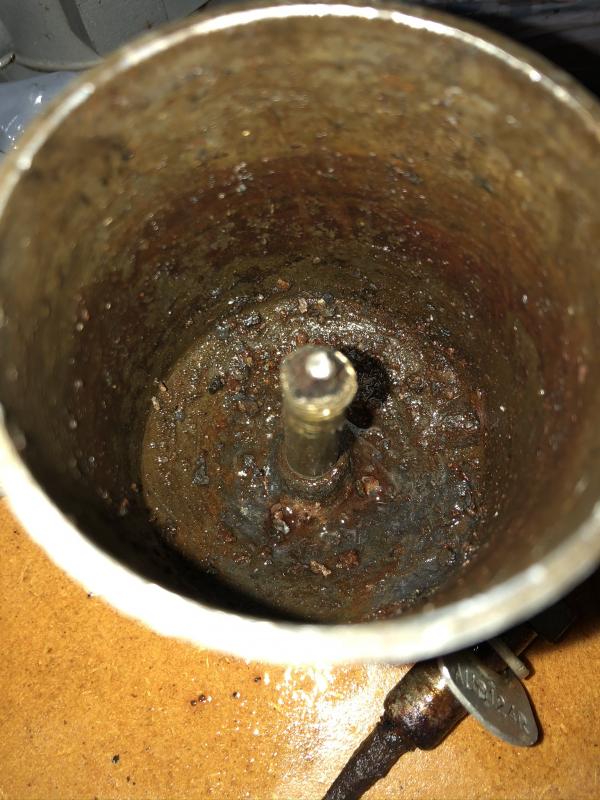

I have a set of HD8 carbs I acquired that had sat for several years and they have a couple of frozen parts I’m trying to get loose to repair. The fuel bowl cover bolts broke off and I’m not sure how to remove the center post that the covers bolt attached too. Any advice? They’ve been soaking in penetrating oil for a few weeks now.

Very direct heat and some vice grips . Heat it quickly but dont burn the aluminum then grab it with the vice grips and wiggle it dont just try to undo it . One it’s moving then unscrew it .

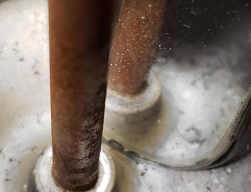

Here's why I'm saying the steel stud is cast in place in the aluminum:
This is a mirror view of the stud in one of my spare HD series bowls. If it were threaded, at least one thread would be visible here. Also, if it were threaded, folks would be pulling them out of the aluminum and ruining the float bowls, as those threads would be weaker than the big nut and steel threads at the top. Not to mention the process of drilling, tapping and inserting the threaded stud would be more expensive.

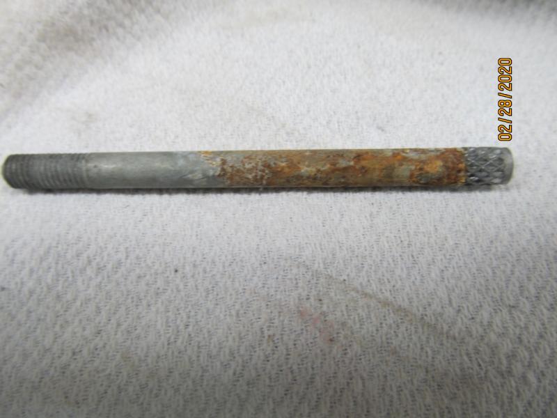

I went out to my shop and cut up a perfectly good float bowl to prove his [steveg's] point. I did not for a minute think he thought there was an aluminum stud (he is waaaay sharper than that)..... But apparently you have never run across steel studs "cast-in-place" in aluminum castings, I have.
Here are some pictures, there is a very large knurl on the bottom of the stud where it is cast into the aluminum - this is often done where there is a strong desire to NOT have the stud unscrew (loosen) in its service life.

This is a valuable contribution. I'd imagined some kind of flange, like a nail head. The knurling is interesting in that when the nut is tightened, the slanted edges of the knurl press outward, compressing the aluminum. This is playing to strength in compression. If there were a flange, that would be shear, where aluminum is weak.

I just talked to Joe Curto and he said he repairs them!
I have to cut off the damaged stem as close to the bottom of the bowl and send it to him. He recommended a Dremel Tool for the job and I have that. He has a special tool to remove whats left of the old stem and he then taps the hole and puts a new stem in that he has made for the job. Price: $30.00 He did say that if I couldn't cut the stem off he would have to charge extra. He also cautioned me to be careful of the aluminum near the stud.
