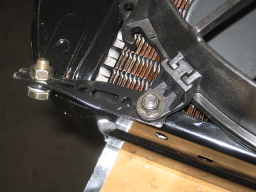

I mounted my Spal as a puller and used their mounting kit. The only modification to the radiator was to drill some holes down by where the radiator mounts to the chassis. The top brackets are mounted with the top radiator rod stays.

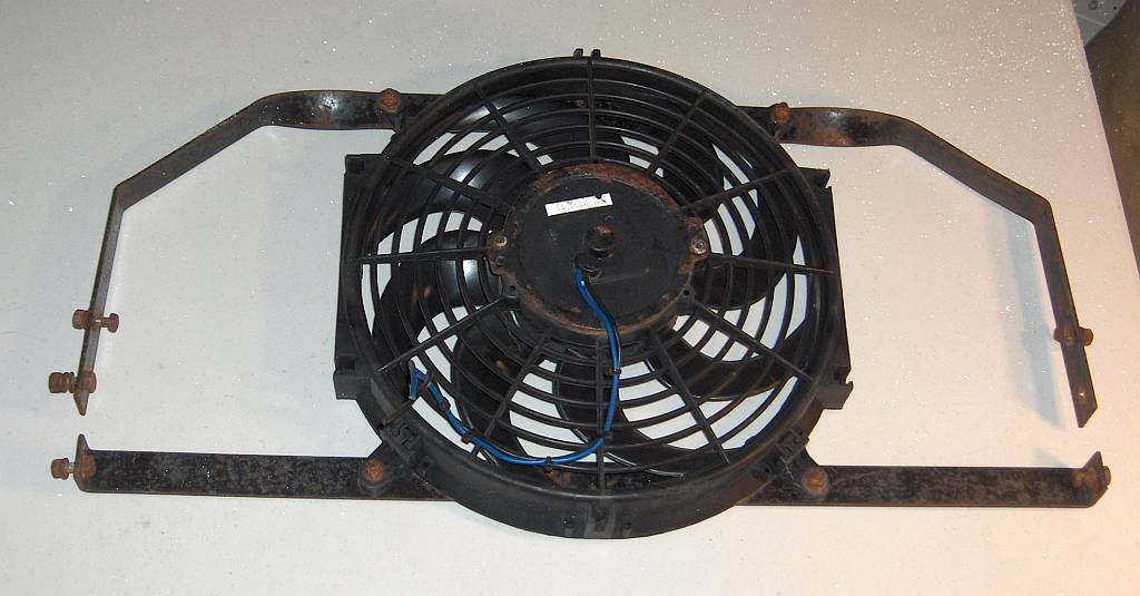

A repost of how I mounted mine. A small piece of bent steel on either side, welded with 3 tacks to the side radiator supports.

Mine was mounted with some simple bent metal straps and then bolted to the front inner fenders. Eventually it will go back on that way. It doesn't interfere with the crank handle.
