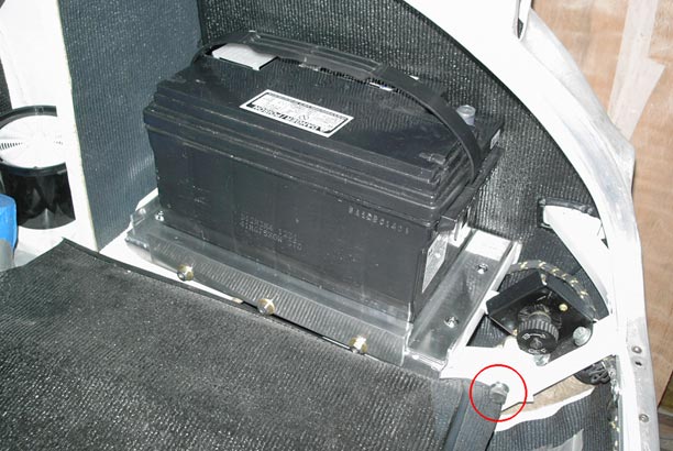

The ground strap for the battery normally goes on the bolt circled in the photo. That's about the only thing I did that was original back there. :smirk:
