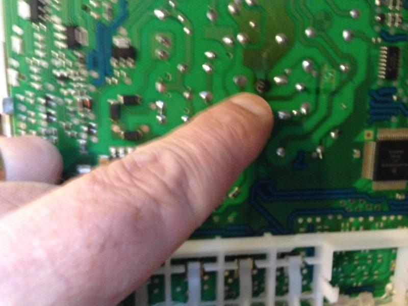

I probably saved myself $125.
So our 10 year old Bosch Dishwasher decided to go nuts on us. It would run, but it would not stop running. It would just run in the wash cycle all day long if you let it. Also, the water was not getting hot like it should. So, I did a little research on the internet and found a post somewhere where a person had the same problem and stated it was a bad solder joint on the master control board, in the circuit that controls the temp sensor. Anyway, I decided to tear it apart and see what I could see. Lo and behold, there was an obviously bad solder joint right smack in the middle of the master control circuit board! I cleaned it up and put some fresh solder on it and viola! It's fixed!
