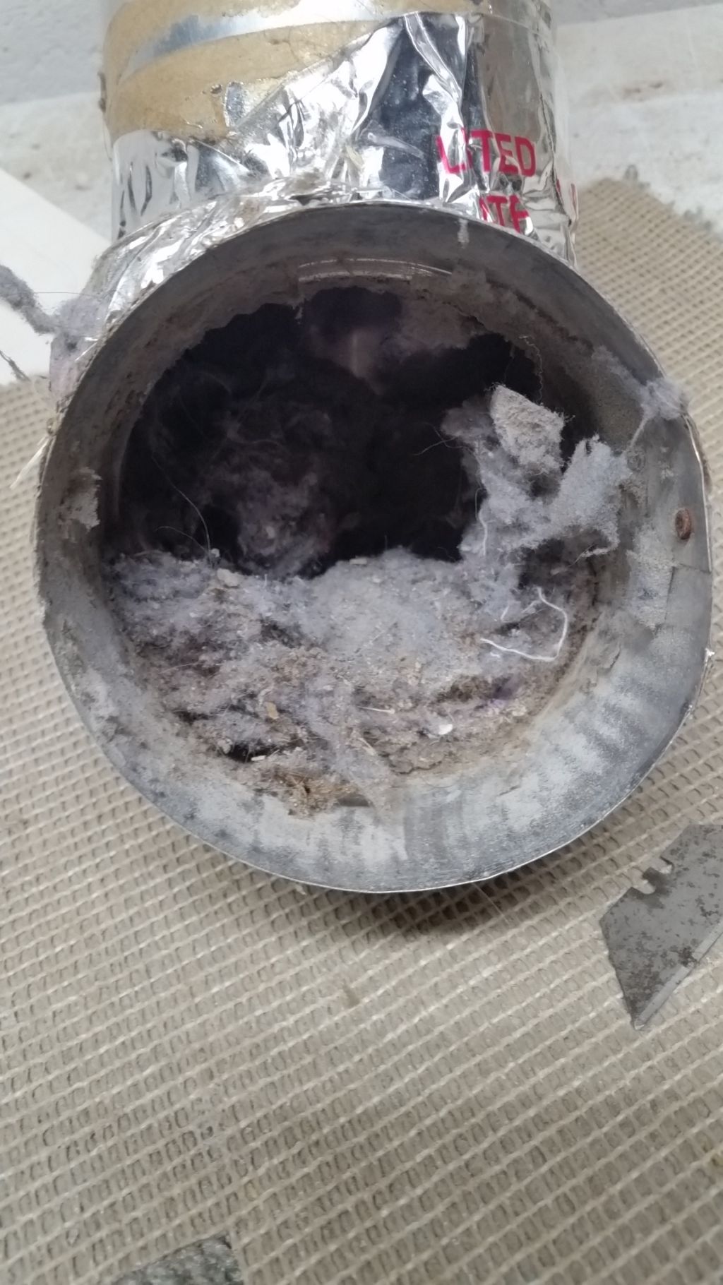

Our dryer has not been drying that well lately sometimes taking a second cycle to get the job done. Had been looking at getting a new one as this one is about 15 years old.
Last nigh my wife said that the top of the dryer was getting very hot. No burning smell but it was almost too hot to touch.
I unplugged it and pulled it away from the wall. When I got the vent pipe off the back of the dryer I could see what the problem was and why it had not been doing a great job of late. Clogged pipes.
Got it all cleaned up and it is back to its old self. Another 15 years maybe. I will check it more often now. I am not sure when I last looked in the vent pipe.

I change the vent hose once a year and clean the fitting in the back. Also I always remove the lower portion under the front door and clean out all the dust that accumulates there.

Our outlet didn’t have a screen to keep outside critters out and my wife started to complain about the dryer taking forever to dry clothes and making a funny noise. Upon investigation I found a chipmunk had made its way into to the duct and all the way to the dryer and chewed the fan which caused it to be massively unbalanced (hence the noise) and then clogged up the duct by making a nice cosy house (hence the slow drying).
Aside from being a fire hazard and all the rest it’s a tempting place for local fauna to reside if it isn’t protected which could lead to all kinds of issues. Fun!
If you have a screen to keep the critters out, make sure you can remove it easily to clean it regularly. A contractor put one on ours and it plugged up with lint before I realized it was there.
