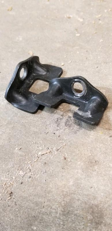

While looking for my spare valve I came across these. Got left off when I installed the engine last time.
As I have to remove the engine mount bolts to fit the brackets I plan to try to scoot the engine forward a fraction as the yellow plastic fan is almost hitting the cross tube.

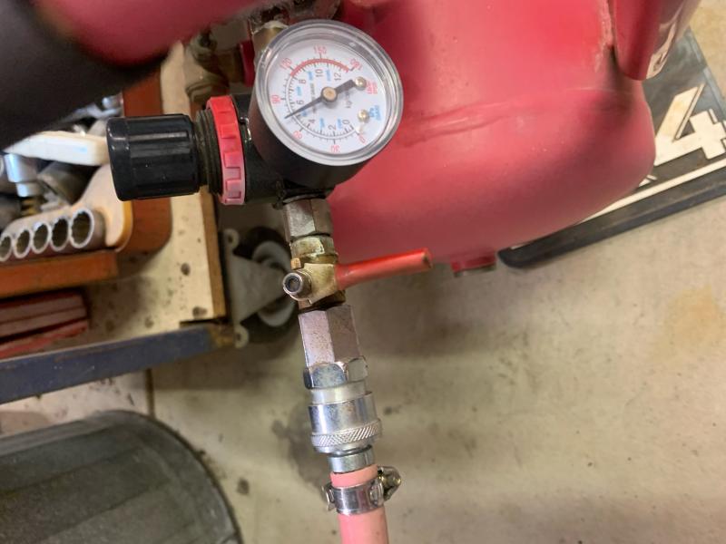

I had the same problem so i used a cheep Chinese job from an old compressor, it's a tapered thread with a bonus outlet thread to attach a hose to direct the water away from the engine and chassis and because its under the manifold who will know?IMG_1865.jpg

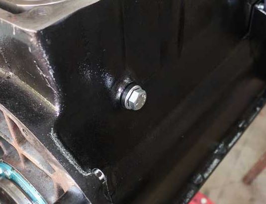

Those %$*@!! valves always leak! I just replace them with a plug. It's a bit harder to reach, but it's not like I drain the coolant every week.
For my TR engine, I soft-soldered a washer to a bolt, creating a kind of flange bolt, and made a plastic washer from Delrin. It's not leaking (so far!)
