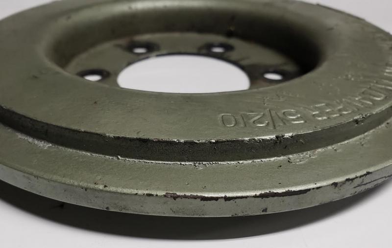

So after looking at Steve Gs pic in post 8 I took what I had to my sandblasting cabinet to see what I could uncover .
Heres the results . My question is does the dampener look useable and correct for a BT7 , the ones on my BJ8s are much thicker .
Also does the orientation of the dampener on the pulley matter ? I see a small drilled section on it which I assume was for balance .
It's the correct older version for your BT7. The later type are only used on late BJ8s.
It's rebuildable. Mine has drill holes in the back from being balanced. Unless you can find an index mark to the pulley, you have no way of knowing if it was balanced to the pulley.
The pulley bolts are coarse thread. Can't think of any other coarse thread bolts on a stock Healey.
Tks Steve .
so if its rebuildable then what exactly is missing ?
You have the two parts of the balancer/pulley combo. You only need the 6 bolts to hold them together (item 37).

The rear of the pulley hub is a sealing surface. If it's pitted, suggest adding a speedi sleeve or redi sleeve.
Tks Steve , good tip about the bolts , never gave it a thought till you mentioned it . Looked in the bolts bucket today and sure enough there are some coarse thread 1” bolts that fit .
This rebuild is a challenge for sure as the guy who took it all apart (not me I bought the car in boxes)didn’t categorize anything , big parts in one box , bolts in a bucket and thats it .
So rebuilding any section is 2hrs searching and finding then sandblasting n cleaning and reassembly is 15mins .
