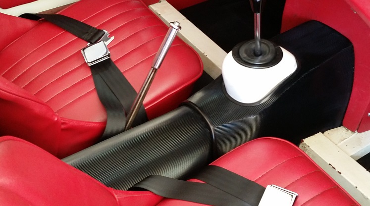

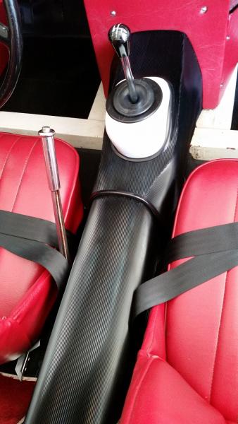

I have begun to replace floor covering in BE with fine ribbed floor mat material to get closer to original. Have completed under seats and transmission tunnel. Starting to work on cross member covers next. Also used this material in doors. Black is the only color available, but it goes well with the Amco mats in the foot wells.

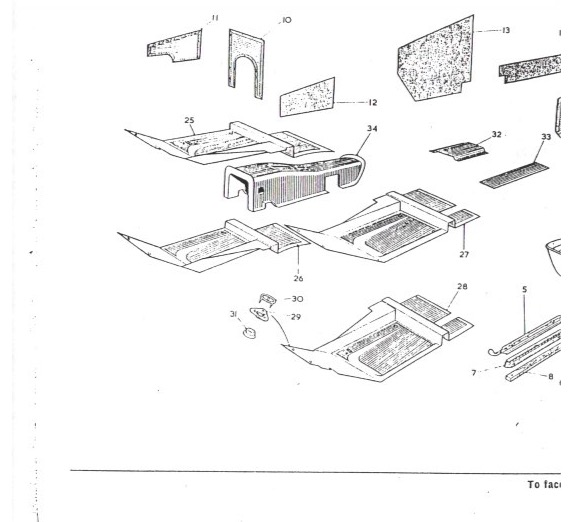

Original rubber floor mats were formed to be integrated as one piece, covering the raised rails, both across, and notched for the rail that runs longitudinally under the seats, and form fitted to the wells. I remember them being formed over the seat rails too, but the book shows them notched. When I bought my first Bugeye in March of 1968, they were still original to the car, though not the best in shape. In today's world, you never would have tossed them like I did back then... who knew... :wink-new:
I do have an original black tunnel cover now though that is in quite good shape.
To confirm my memory, I checked Bugeye Service Parts List; witness scanned plate attached.
