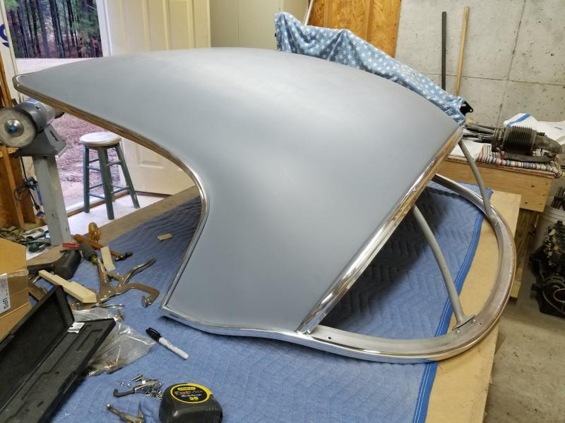

I also followed Lin when I rebuild the Hard Top of my AH 100 6 Longbridge 1957
I have put on my album some Photos that can be useful in the rebuild
https://photos.app.goo.gl/pz9Ne26CS... 4 Healey UK -http://www.ahead4healeys.co.uk/
I used Lin's article and the article by Roger Moment in Chatter Mag June 1998. I ordered all parts from Cape Intl. Steve was extremely helpful with parts needed. I got a couple of BJ8 hardtop front hold downs and was able to modify them to fit my BT7
