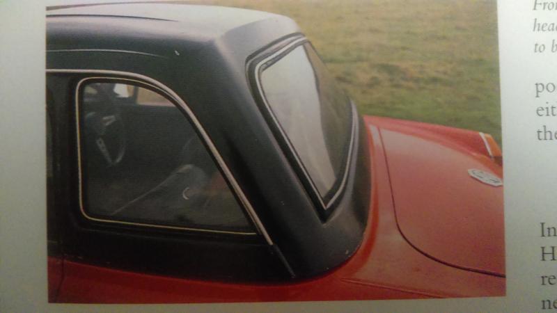

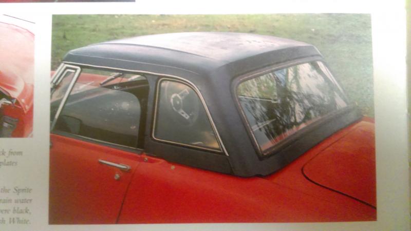

The key to the difference is the rear cockpit area; beginning with HAN9 ('66 onward) has the larger opening with the raised cockpit surround, and HAN8 shorter, flat cockpit surround (like yours).
Below is early (fits HAN8) and late (fits HAN9), respectively.
