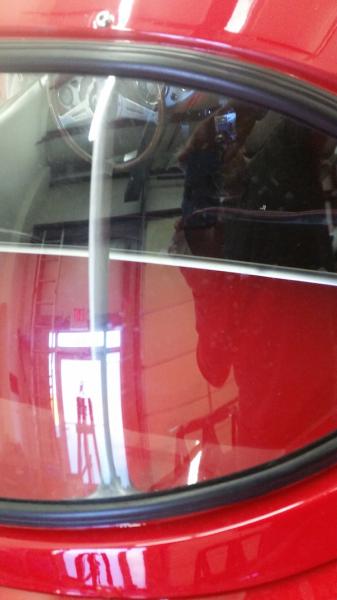

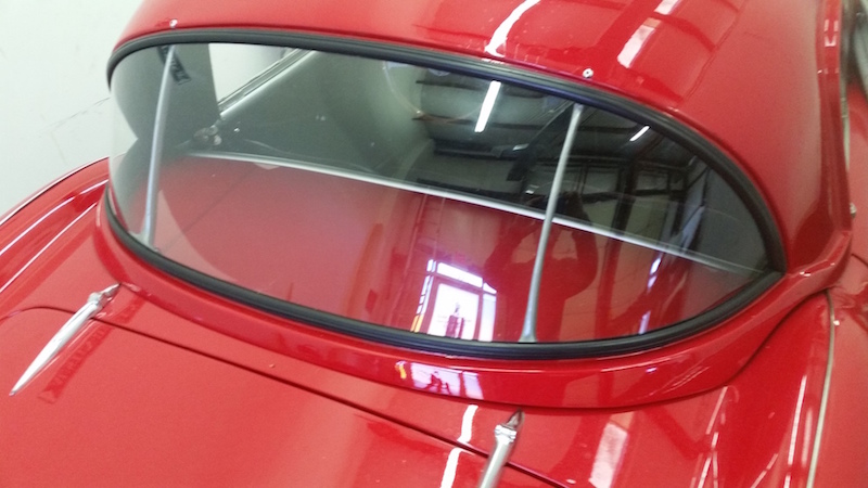

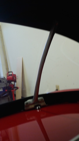

Patrick--
You asked for pictures of the stays. See the attached thumbnails. They are fastened to the bottom rail where it slides under the fittings on the back deck of the car.
