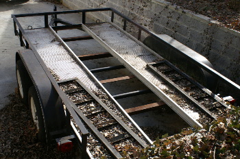

Kerry, doing it the way you are thinking of would mean the ramps would need to be about 25' long depending of course on how high off the ground you want to build it
Willie:
Yea roughly 15'- 25'. I`v gotten the car {TR} on a fairly high trailer with 10' ramps but it was slightly dragging the underside so I know for a fact the ramps will have to be at least 15'.
I`m thinking for me, I can`t reach above my head very good anymore, so I might want to be just high enough off of the ground so I can crawl under and lay on my back.
Im not to keen on sittin on my buttox either. I can barely ride the 100 or so miles to Grandmas house hahaha. But that`s sittin for two hours in one place where as turning wrenches will be more of an up and down situation.
I`ll have to measure and see if I can go high enough in my garage to accomodate a small stool of some sort.
It`s about sixes as of now which way I might go tho.
BTW. my garage is 40' deep and 24' wide I think the cieling is at or near 10'

beaulieu said:
...how would you improve on this idea?...
Look at a standard roof truss, and observe the difference in triangulation when compared to these units.
The taller you go, the more unstable side to side things become. Especially when it's two units acting seperately. As shown in the pictures, you'd be unpleasantly surprised at how easily the cars can be knocked over. Btdt. Tie the two sides together. You can still make it adjustable with slip joints and pipe sections.
The taller you go, the more unstable side to side things become. Especially when it's two units acting seperately. As shown in the pictures, you'd be unpleasantly surprised at how easily the cars can be knocked over. Btdt. Tie the two sides together. You can still make it adjustable with slip joints and pipe sections. [/quote]
If you look closely at the pics it looks to be tied together where you jack the ramp up but personaly I would tie the front and the back together also
If I build it, it wouldn`t be portable in any sense if the word IT WOULD BE ANCHORED TO MY GARAGE FLOOR! AND TIED TOGETHER BOTH FRONT AND REAR {boxed}. The only movable parts will be the ramps. To allow for more room to park other vehicles closer to it.
BTW .... 2x2x1/8 angel is OUT of the question!
I WOULD USE 3X3X1/4 OR EVEN 3/16 I DON`T WANT ANY CARS FALLING ON ME ANYTIME SOON!
I will be using 2x2x3/16 which I think should be substantial enough for the max weight I want to use them for (a midget and a mini)and not both at the same time.lol
Structure integrity would come from the upright and cross bracing of the boxed sections, Given enough bracing, even 2x2x1/16 would work. However, I intend to make storage space out of the boxed sections, therefore excessive bracing would be a hinderance for my purposes. It`s a fine line where material size and design fit together. I may even go to square and/or rectangular tubing for some of the structure. Once you start using your "ramps" you should be able to determine where aditional stregnth might be needed and add it accordingly. That bieng said, I would aproach the first few times using the ramps with caution. If something looks weak or distorted, by all means shore that section up.
I have some square tubing left over from an abandoned locost project that I was going to use for the tread section and was thinking about putting some expanded metal on those also as I am always dropping stuff lol
