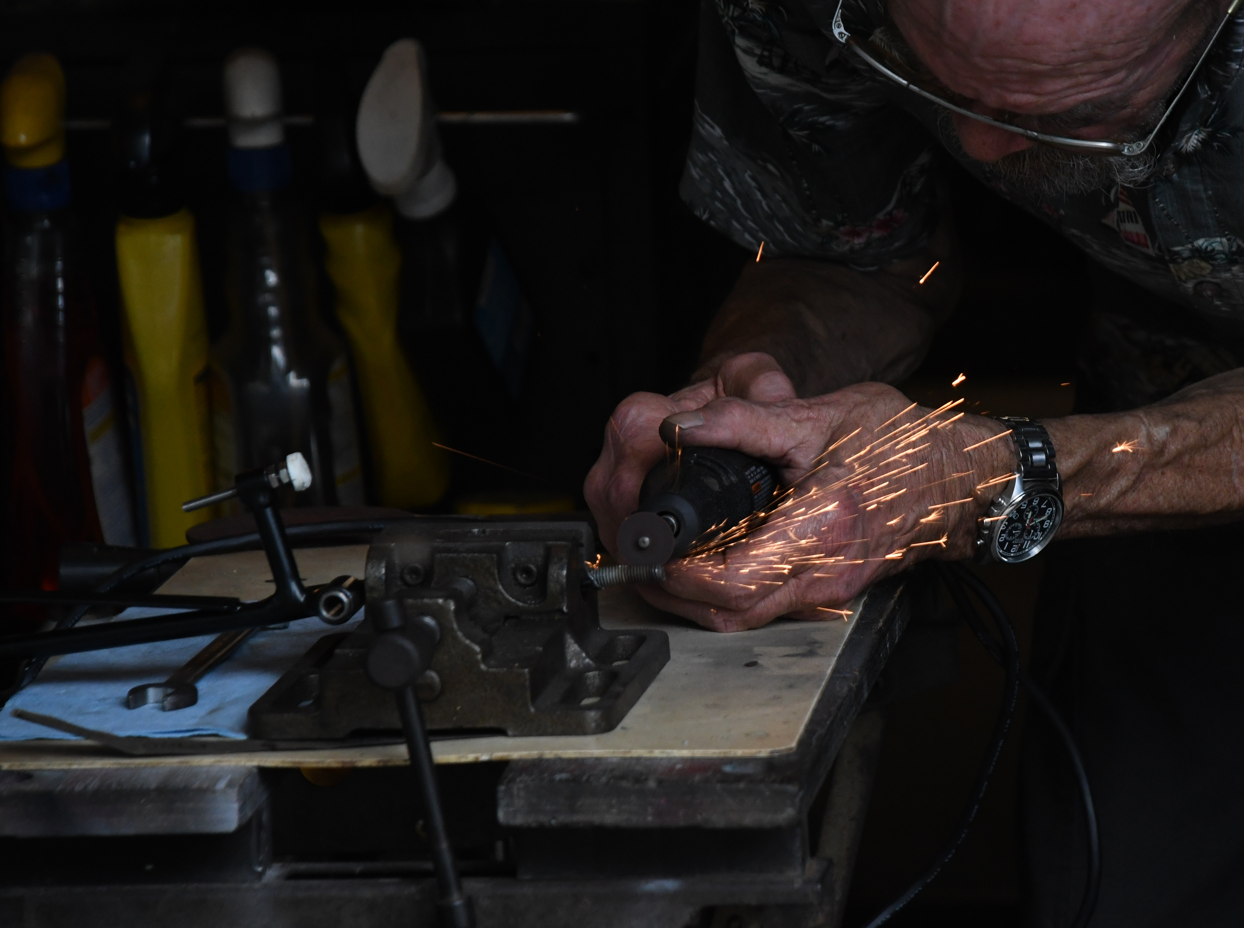

Caveman fabrication. The gas pedal in the vise, 8mm bolt threaded into the top end and hole for the cable drilled. Cutting a slit in the bolt here, to allow cable insertion. Note the "fleurettes" at the ends of some sparks? ASTM/ASME spark test!
