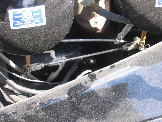

Here's a link to closeups of the linkage:
https://www.mgexperience.net/journal/tmorehouse/1263
I just tried the whole thing again. Sat in driver seat, pulled choke knob with one hand - pulled out about 1/2 inch. At that point the jets haven't moved - only the "play" in the levers.
Pulled with two hands, knob pulls out another 1/4 inch or so. Jets are just beginning to move down. Knob won't go any further unless I brace my foot on door hinge and pull with all my strength. Then knob moves another 1/2 inch. At that point the jets are equally down about 1/2 inch, and front jet lever is parallel to stationary arm.

Yes Tom that is part. I was in a hurry and did not see the sub-listing. Anyways I had that in wrong once and could not get the choke to work. If you were to reach in with your hand and grab the choke arms, can you pull them back together easily? Tr3 chokes are tuff/tough to pull out, but yours sounds a little too hard. Perhaps the little cam lobe that you were working is binding. Or perhaps there is not enough cable sheathing pealed back from the center cable and the little crimping bolt/ pin bottoms out before the jets come out; I saw that once. The jets need to come out at a max of about 3/8 for those things to start when it is really cold, so make sure you have enough travel. It has been my experience that choking problems on a tr3 account for a lot of other problems so spend some time with this one and try and get it right. Anyways try that.
Sp53
In your photo, you have the yoke that connects the two choke rods on the wrong side. See my photo. The yoke goes on the other side (nearer the block) that where you have it.
Also I have about 1.5 to 2" of stranded cable showing between the clamp where the sheath is secured and where it's attached by the nut in the choke rod under carb #1. In your photo, you have no more free cable to let you pull the knob any further. Your brass choke bar that pulls down on carb #1 is already bottomed out by the clamp position.
Don - moving that yoke to the other side is something I'm going to do tomorrow to see if it changes clearance and "pull" of the cable.
You mention I have no more free cable in the photo. That photo page in my link has three photos. Which picture are you referring to? In one picture the front carb choke is off; the lever is fully vertical and there's 1.5 to 2 inches of open cable showing. In the other picture of the front carb, the choke is fully down (about 3/8 inch). That's why there is no cable showing? Did I not understand you?

Tom - I was looking at the wrong photo. Sorry. I see the other photo which shows the 1.5 - 2" of cable. That's fine. With the yoke on the far side, the cable lays straighter and doesn't seem to have an abrupt twist in it near the end where it is secured to the nut on the cross rod. This should make it easier to pull. BTW, I still have the original return springs on mine. 49 years for these springs now, and hardly ever been used. I rarely use the choke. I have pulled it on occasion and found that the springs don't always pull the choke rods back up. Then I'm running rich.
