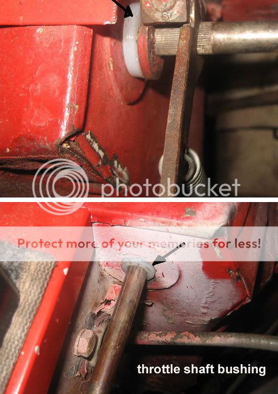

Soup, as for the throttle shaft bushings. The throttle pedal is attached to a rod that passes from one side of the bulkhead to the other. You can see it from the engine bay, and where the carburettor linkage attaches to it. There is a bushing in each side of the bulkhead (on either side of the transmission bell housing). If those bushings are bad, they are much easier to replace when the transmission is out.
Hola Soup, Hey Shawn!
Soup, your throttle bushing are shot, no doubts.
Here is a quickie photo of the installed assembly
Shawn is describing. This is one of those cases
where you have gone to great effort to get the tranny
out so why not take another 1/2 hour or so and install
new throttle bushings. Your gas pedal response will
be ever so much smoother. /bcforum/images/%%GRAEMLIN_URL%%/driving.gif
I'll post more how-to-install photos later this week.
Dale

I checked the car tonight and sure enough one of the throttle bushings is loose and the other is missing.

Anyway, you guys are right and the bushings need to changed.
