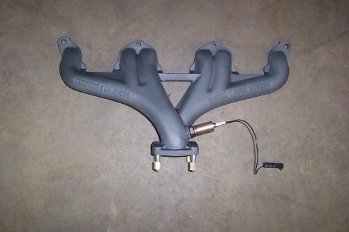

This is where I mounted the O2 sensor for my TBI injection system. I put it at this location on the manifold because there is a hole there in the divider in the manifold. This way the sensor can read both halves of the engine. It seems to work well in this location.
