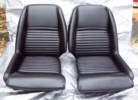

These quickly sold on ebay a few years ago, think I listed them as buy-it-now for $300 which I thought was pretty high at the time. They came in my TR4A. Now I know why the guy grabbed them up so quickly. The were in really nice shape, not perfect but close and he was doing much a you are, a long term project. So this is what you are looking for if you have an early GT6 MK1.
