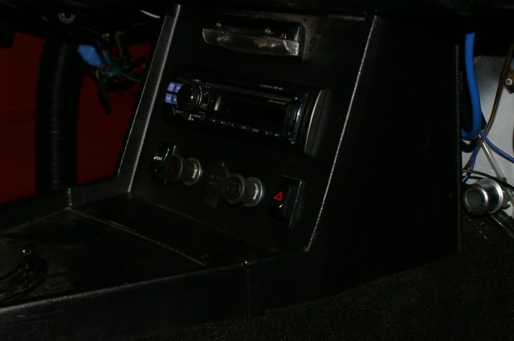

In the meantime, Friday I managed to install the evaporator/blower assembly for the heat and A/C. Thanks to some ideas gleaned from other folks, I decided to pitch the little control pod for the fan switch and temp control - this little lovely:
...which can be mounted alongside the center console or ~wherever~, and which looks kinda tacky.
So, here's where I put the controls:
Looking right to left, there's the hazard switch, the temp control, a port for 12V power, the fan switch, and a dummy switch which can be used for something else down the road.
And here's the evaporator/heat exchanger/fan unit under the glove box. Still plenty of leg room:
Gettin' there!

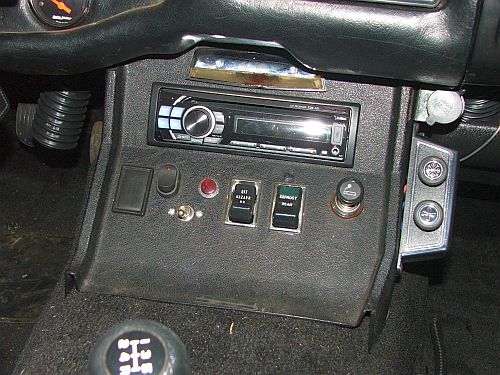

Mickey Richaud said:
Gettin' there!
Looking good!
That's the control unit that came with my a/c system.
Temperature control and fan speed.
I mounted it to the right side of the radio console.
I have an additional 12v plug located above the a/c control.
I do like how you incorporated these controls into your console, though.
Re: GT Update
That's the one. Even though the fan unit doesn't take up too much room, I wanted the room next to the console to be free, and wanted more of an integral look. The console is the European model, and the holes are for warning/indicator lights. Larger than necessary for the switches, but a couple of washers took care of that.
The wiring harness for the switches is already hooked up to them, so when it's time to have the A/C charged and wired, the console won't have to come out. Again! :crazyeyes:
Have to run the hoses to the vents and install the hoses, and then it will be ready for charging.
Rick - I believe you hooked up one of the outlets to the defroster vents. Is that really that useful? Not sure what I'm going to do there.
Mickey
Mickey
Yes.....with this unit, if you want air to be directed to the defroster tubes, you need to sacrifice one of the face vents.
So I have one vent to the end of the dash on the passenger sice, one vent to the middle of the dash (face), one vent to the driver floor (NASCAR style), and one vent to the defroster tubes.
