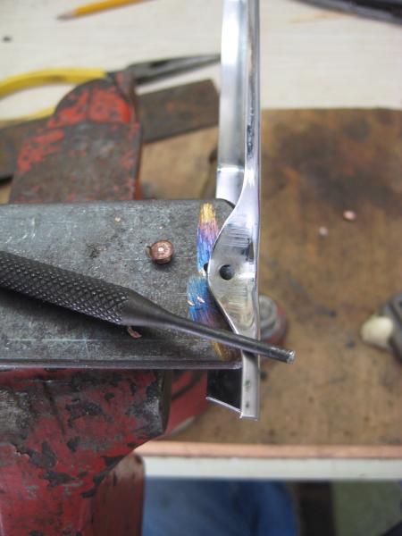

Mike, I did the same thing a few months ago. I purchased a decent grill on eBay and decided to disasemble it so it so I could polish all the surfaces.

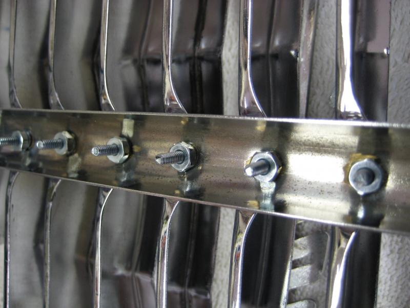

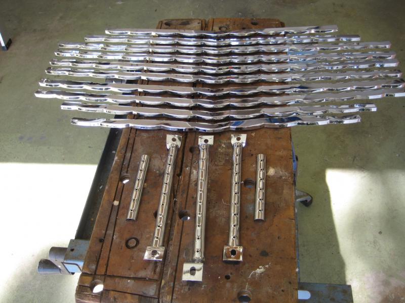

I started by removing the rivets by using a drill with bit to remove the back side of the rivet. Once the rolled part of the rivet was removed, I used a small punch to push the rest of the rivet out. I also build a small jig to put in my vise to help remove the rivets. Once all the parts were disassembled, I used a drill mounted buffing pad to polish them. When I reassembled the parts, I Used small bolts and nuts instead of rivets. Part of the reason was that the bolts and nuts were much easier to use and also the thought that if I wanted to disasemble the grill again in the future, it would be a piece of cake.

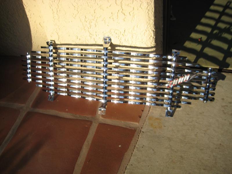

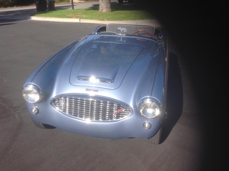

I was very pleased with the results. You can see how well it turned out.

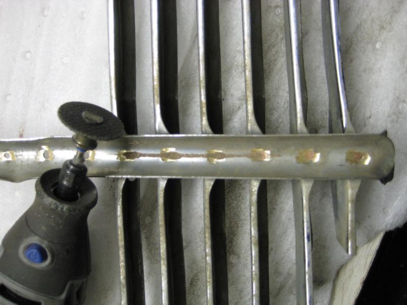

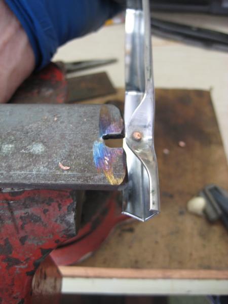

Mike, I found the photos on my iPad, so I've attached a few. I forgot I used a Dremmel with a metal cutoff wheel and not a drill to remove the rivets. Also I included a shot of the jig I used to punch out the rivets. Hope these help. I think it took me about 4 to 6 hours to disasemble, Polish and reassemble.

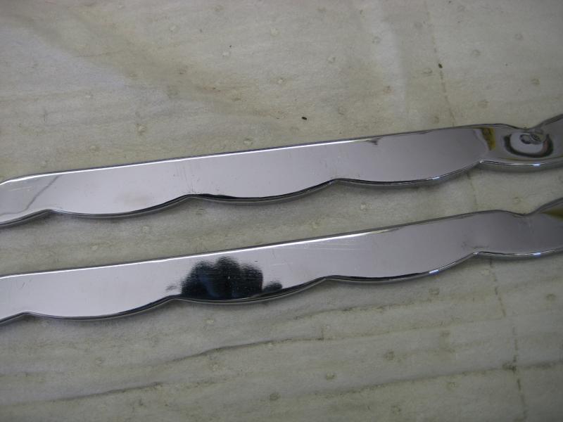

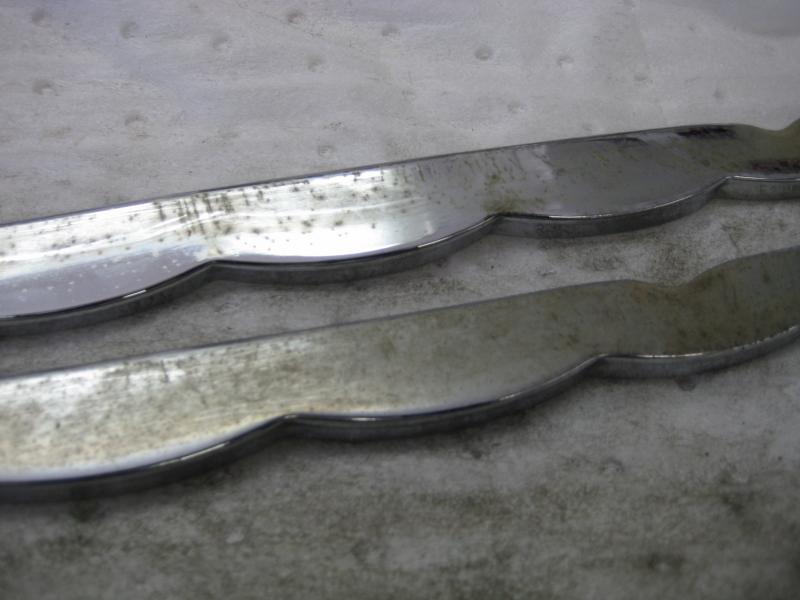

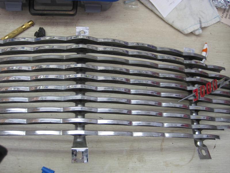

Here's a few more with some before and after photos.

I used a liquid chrome polish, the standard kind you find in auto parts stores. Nothing fancy. I applied it with 00 steel wool. Maybe did it twice and then used a cloth buffing pad attached to an electric 3/8 " drill held in a vise. Used both the red and white compound that came with the buffing kits. I don't remember in which order, or if one worked better than the other but I suspect I used the courser one first. Finally I used semichrome before I reasembled the pieces.
I was very happy the results and after hours of body work and stipping parts, having shiney pieces was a great joy.

No I didn't use stainless nuts and bolts but probably should have although were I live, corrosion is not a problem. I did put a drop of thread lock on each bolt.

Hardware in that small of a size (either 4-40 or 6-32nds?) would be inexpensive enough to spring for stainless steel, and likewise, the use of Nylok locknuts. Much cheaper to buy in boxes of 100 pieces than at the local ACE HDWR store; nearly EVERY town has a fastener supplier in it, and even mail-order shipping something that small will beat individual retail pricing.
