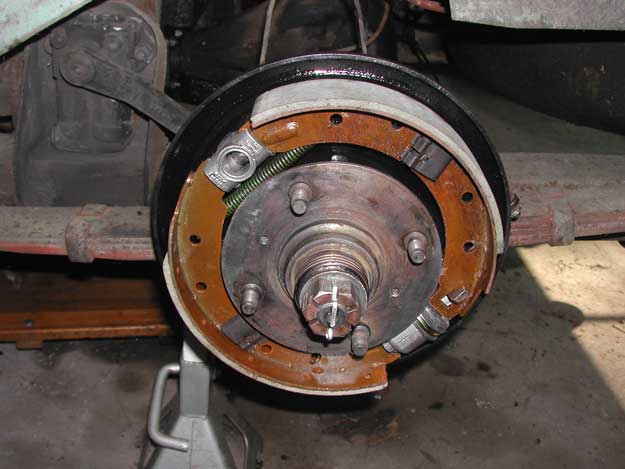

TR3driver said:
Could be mistaken, but I think John has the upper return spring on the wrong side of the shoes. At least I know it's supposed to go behind on the earlier brakes, and I don't recall it changing.
O.K., I'll flip 'em around when I install the new shoes.
Good catch.
Does this look any better, guys?
Should get more rear braking this way, eh?
Are the springs the right way round, Randall? I hope so; they only worked for 25 years when they were backwards, and I'd like them to last this time.

Sheech, now I'm going to have to pull mine and see which way I put the springs on. For sure I don't remember. Maybe I can find a picture..........
so many little things to remember!
Tinkerman
Just looked at a picture and yep! I got them correct! Yea!
Looks good to me, John.
