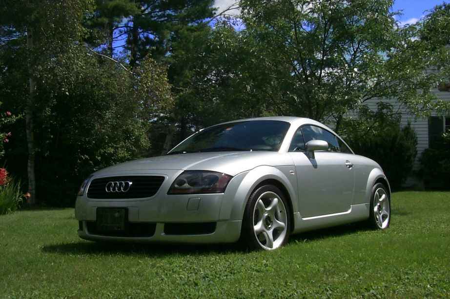

The KKK is a nice little turbo. Got one on my Audi TT 1.8 Stage II chipped with a Garret ECU. They have a very smooth, wide HP band without the lag you get from larger blowers. I think you'd need FI and an engine management system to tune them correctly.
I know it's not a Triumph but ..
