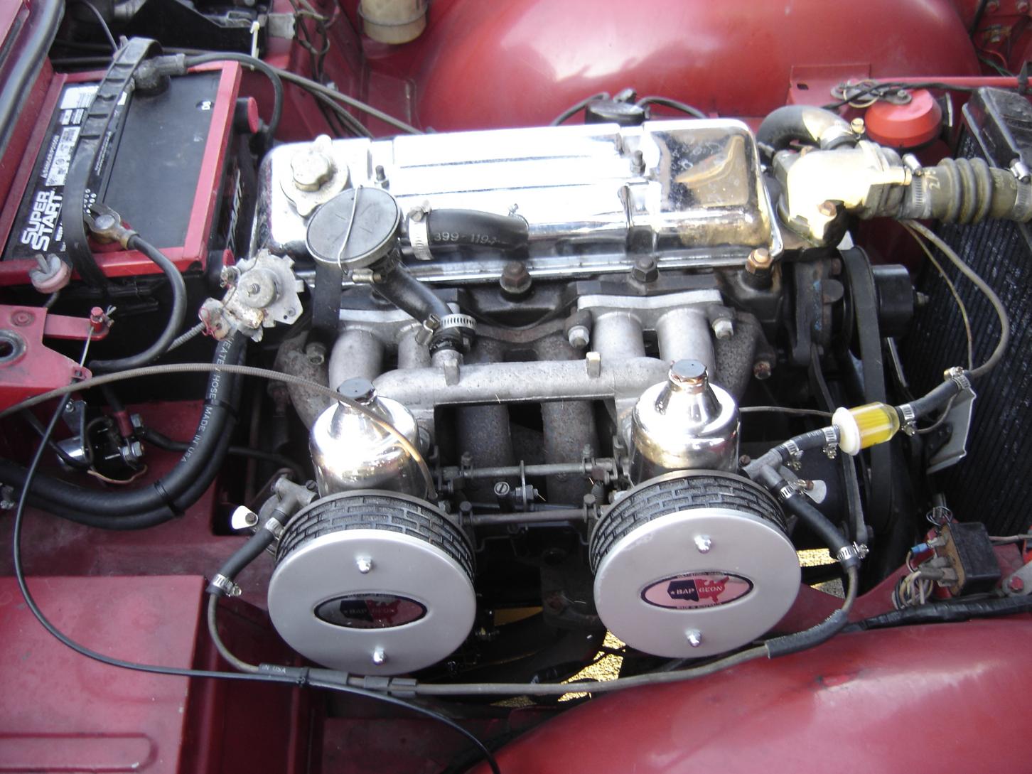

There are paper elements available but I just use foam sleeves:
For the late TR4 (like yours & mine) the filters are smaller and I found the foam filter made for a ShopVac could be sliced into covers for those.
