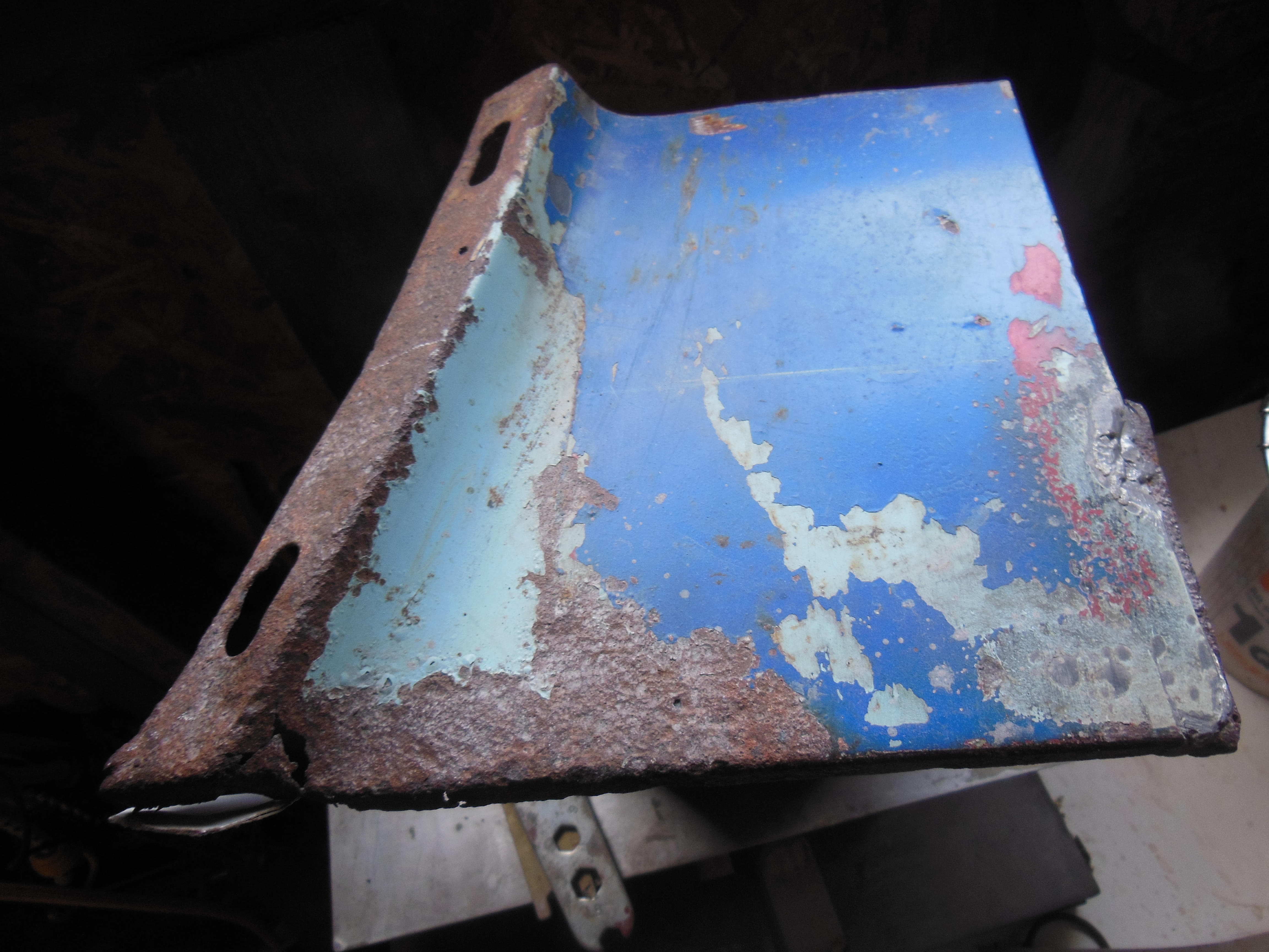

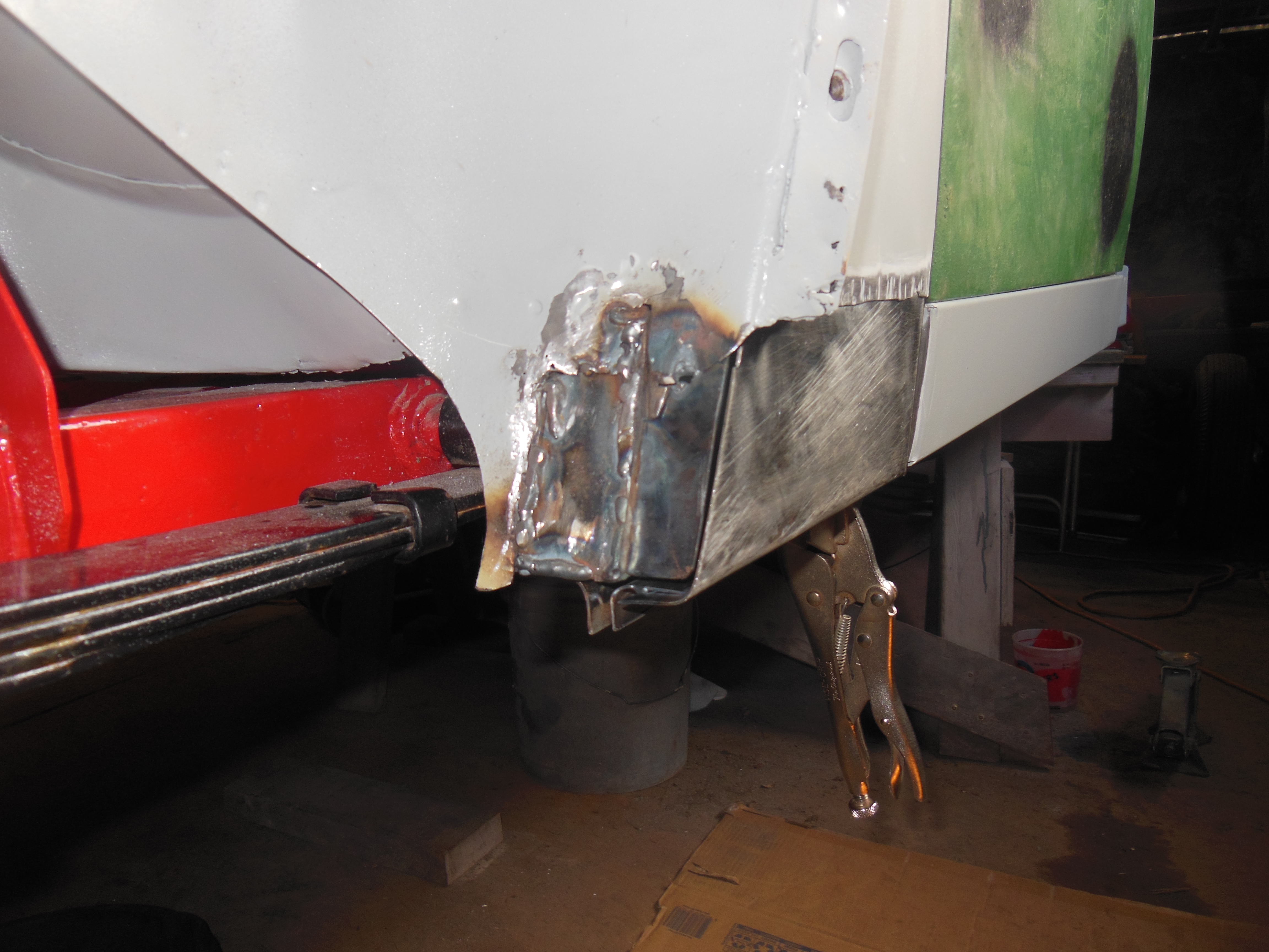

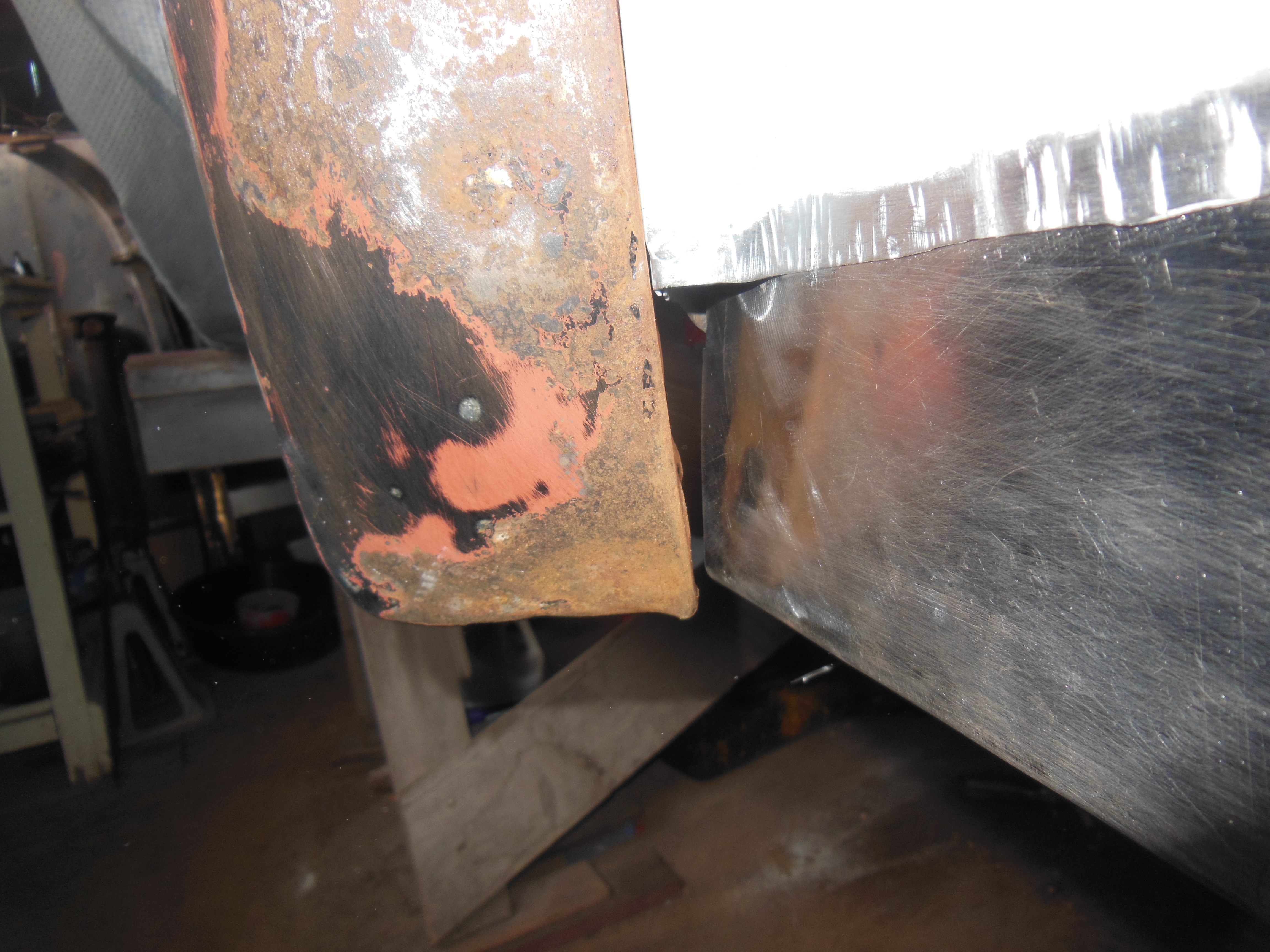

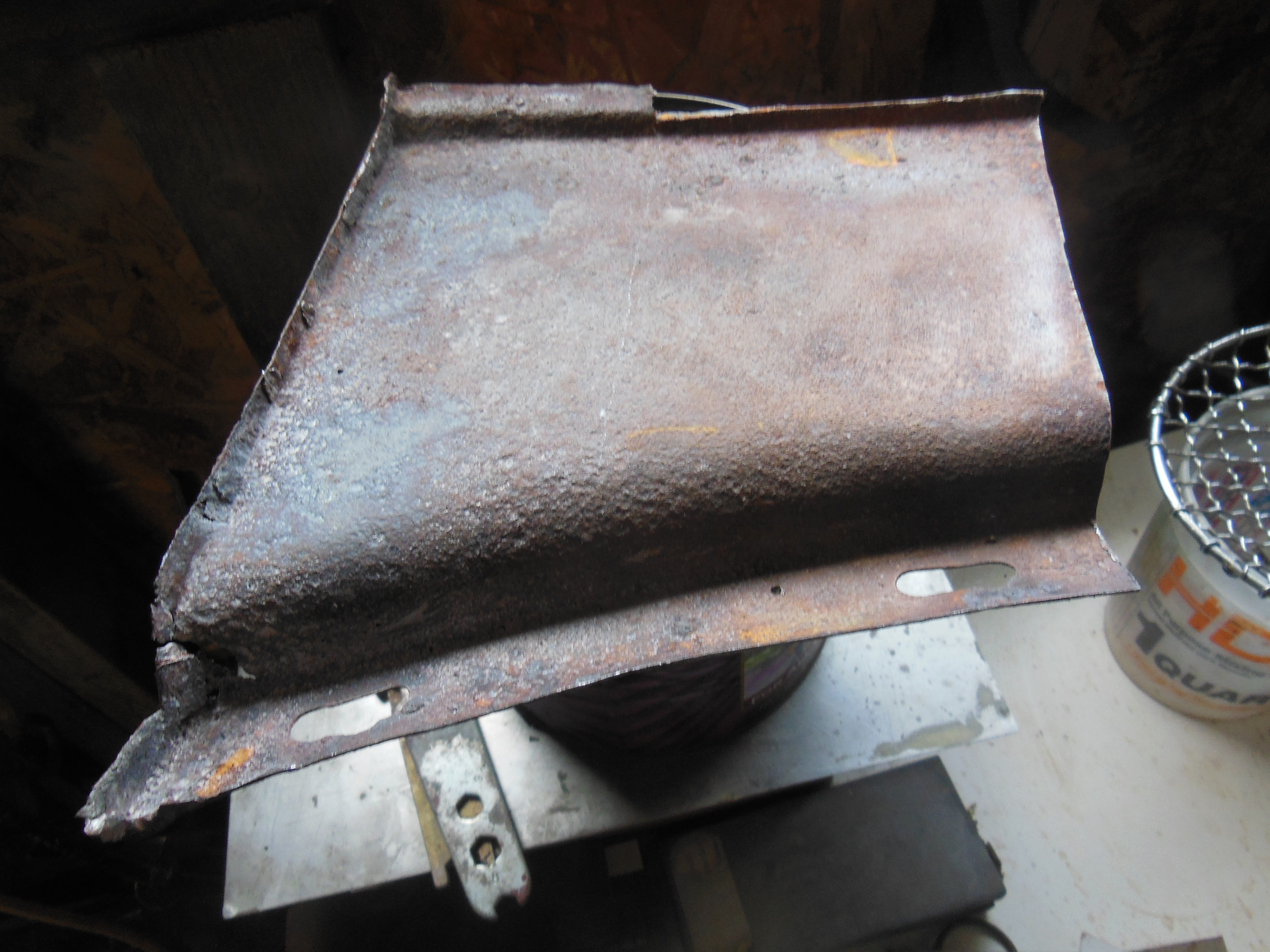

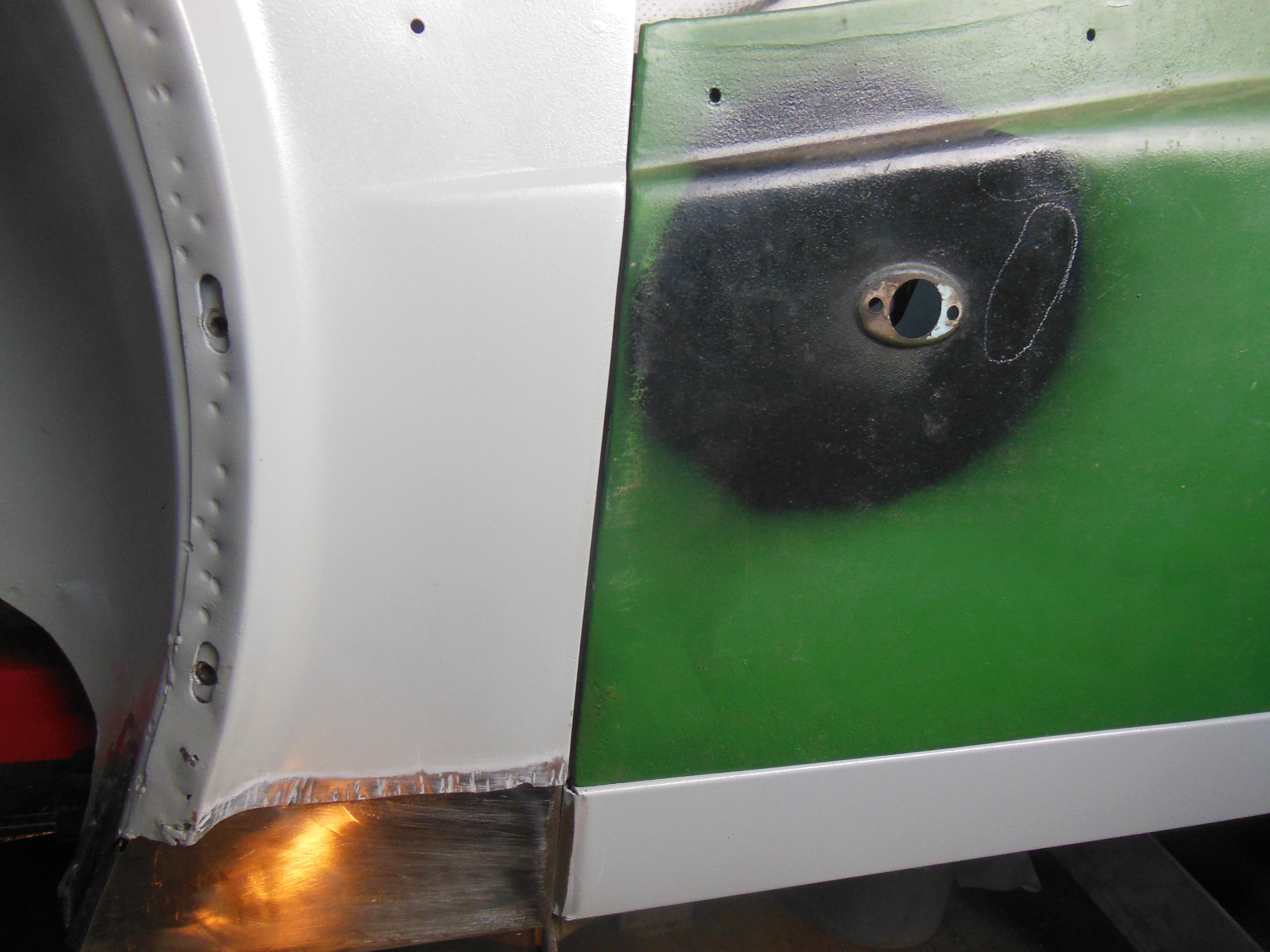

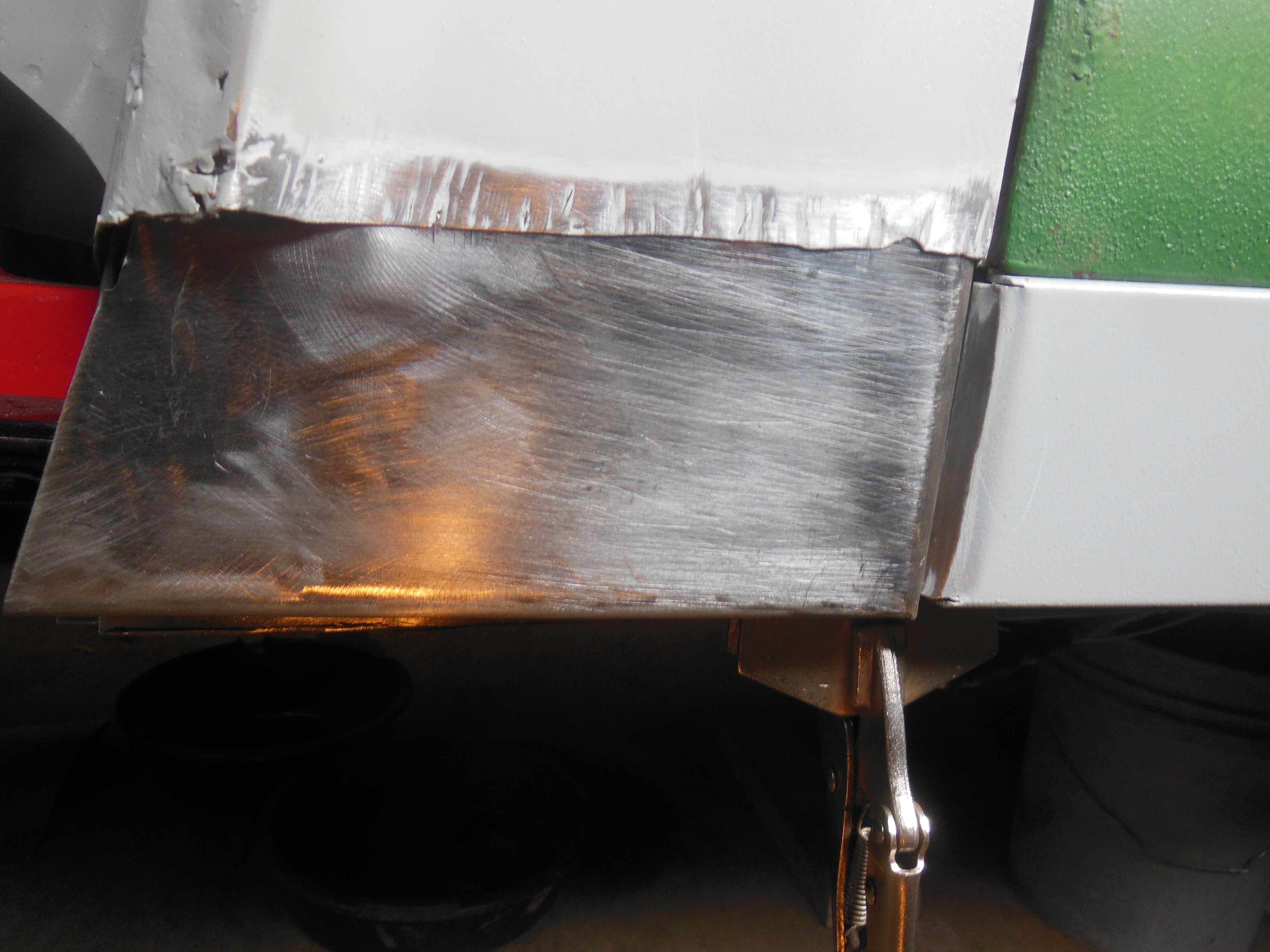

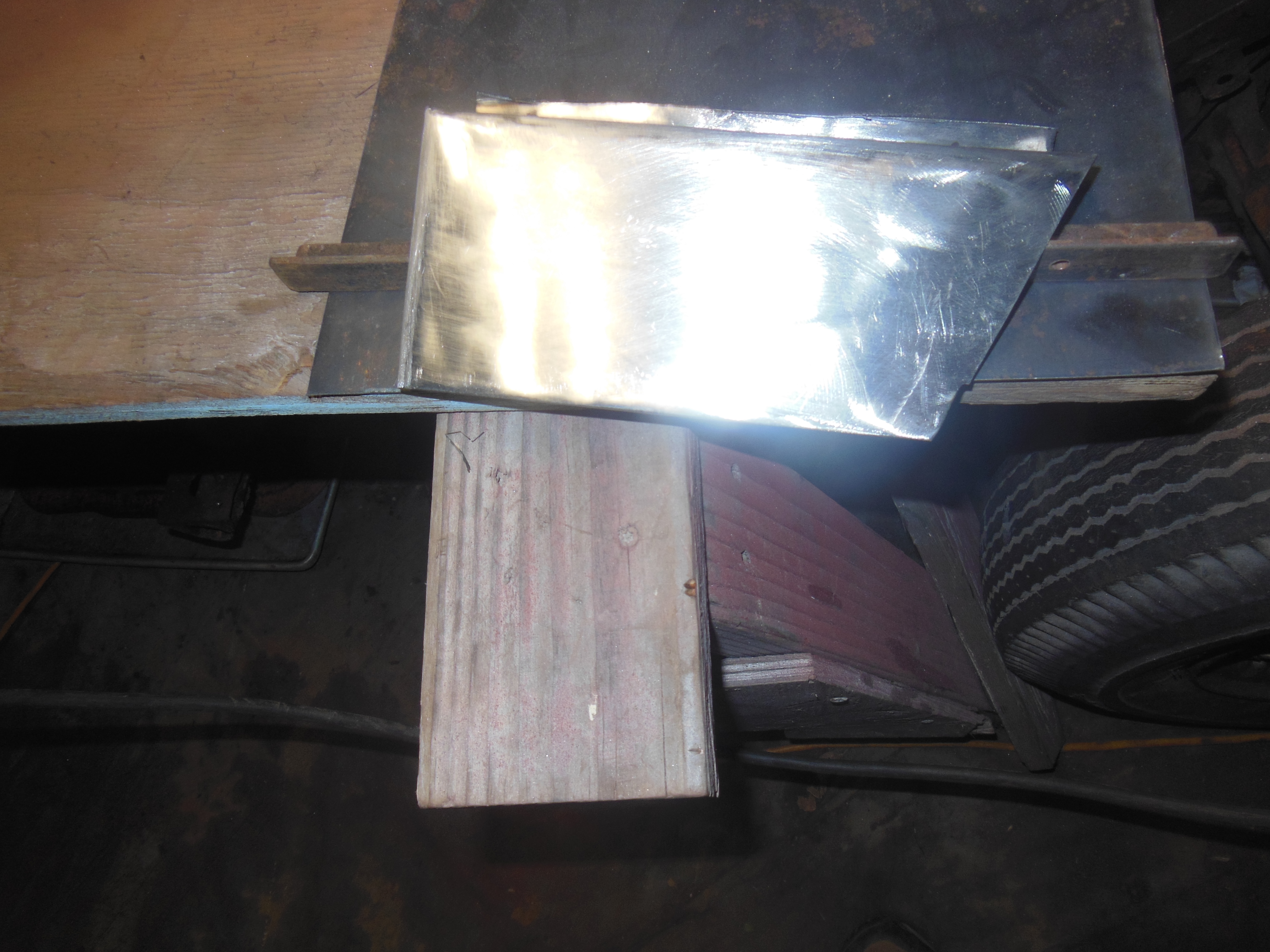

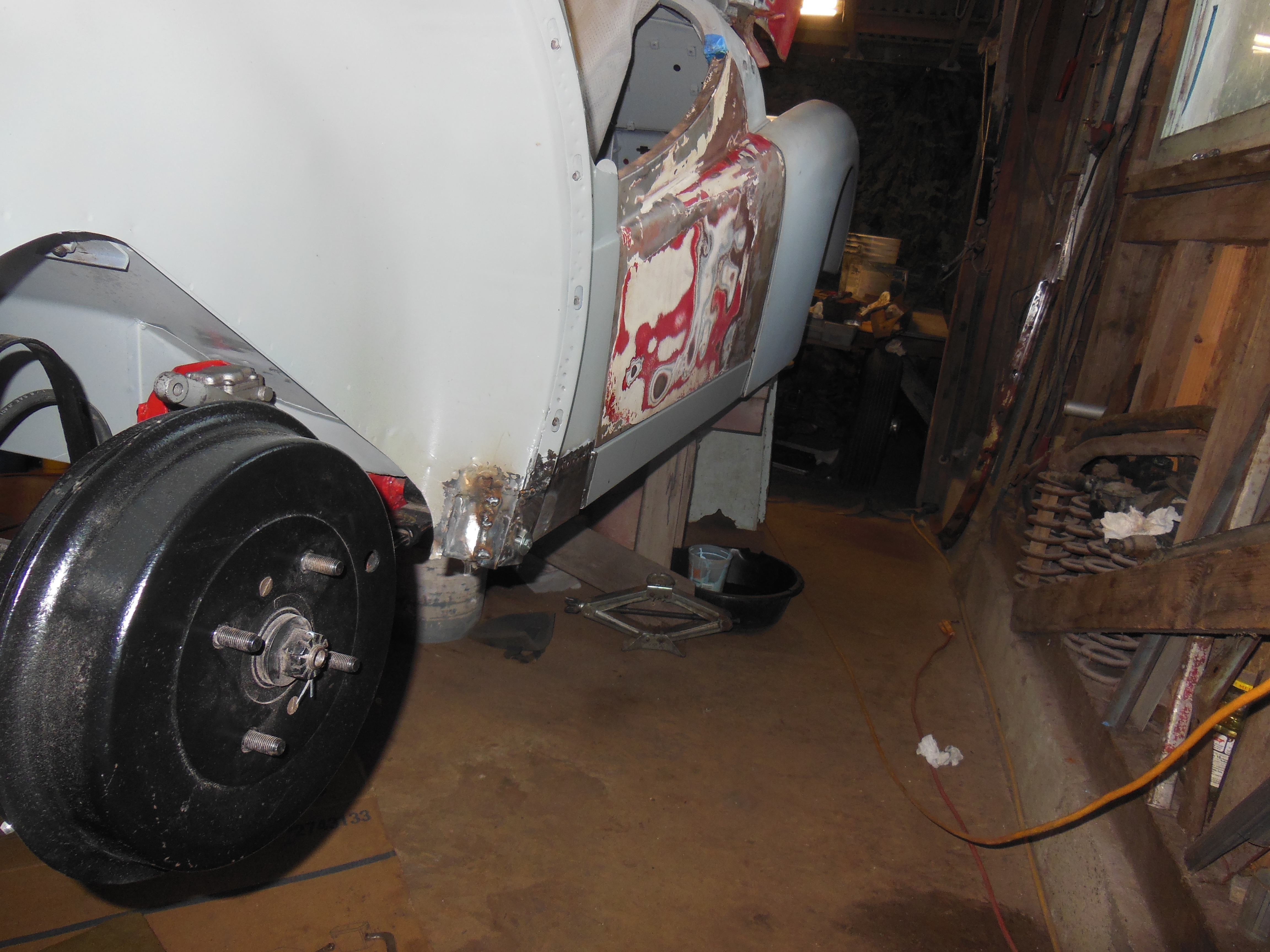

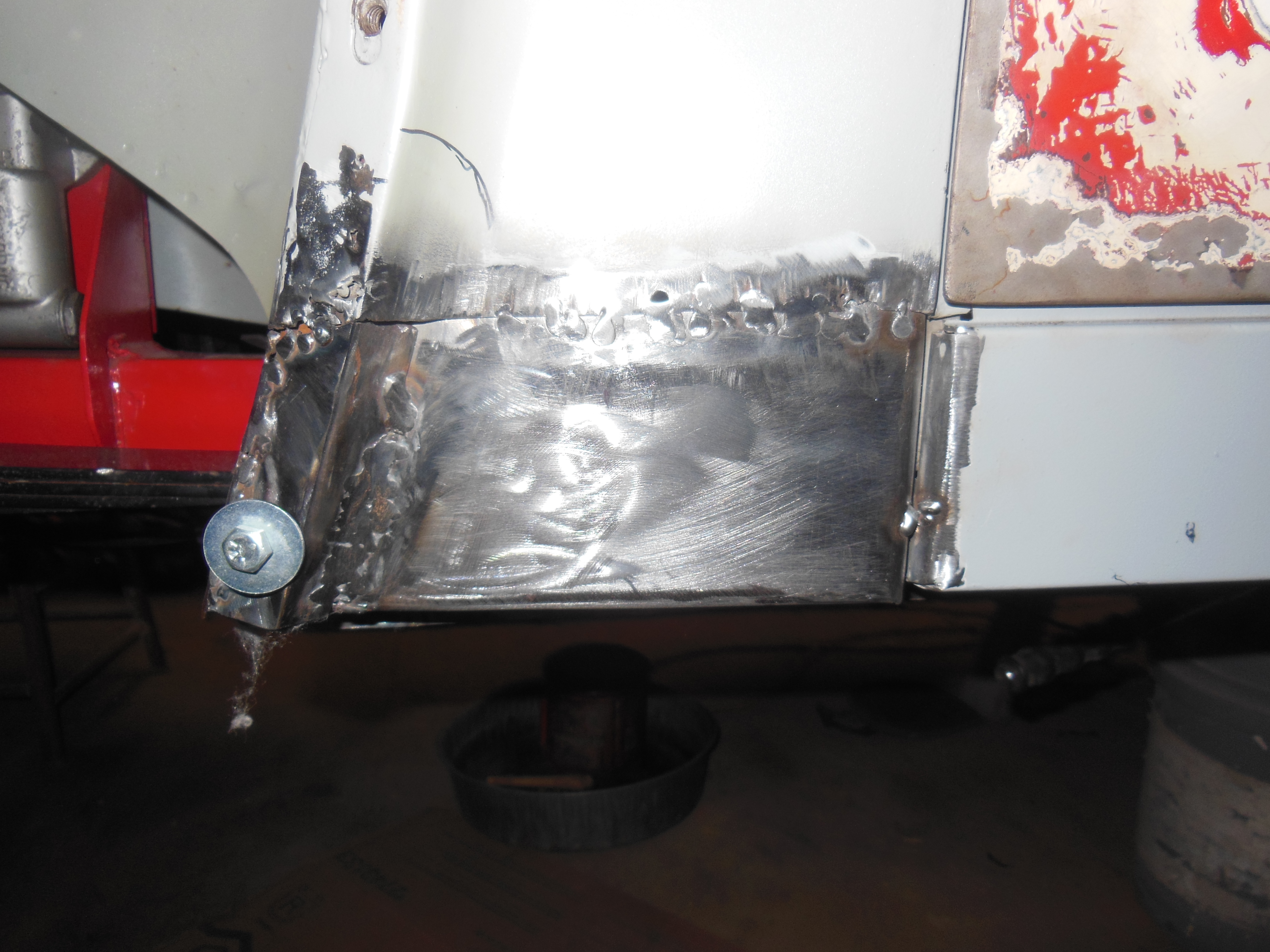

I made a small piece to use on the bottom quarter panel, but I am afraid to try and weld the piece in place along the front. I can weld the bottom and both sides, but where the 2 piece overlap in the front, I know/kinda that I will burn through sorta. I am thinking about gluing it with panel adhesive. thoughts and ideas please

If you have a good automotive paint and body supply shop near you, pick up 3M Panel Bonding Adhesive. It's a 2 part epoxy that you run it through a gun with a mixing tip. If you do your panel prep per their intructions, when it sets up it's not ever coming back apart. I've seen demonstrations where the metal tears before the panel bond lets go.
3M Panel Bond
I second the 3m product. It is great and a good replacement for welding. Also, a body guy I know uses it to re-form small body parts. It looks a little like JB weld but you can form it. He then sands it down and you can't tell it from a piece of metal.
Thanks you guys I will look into the glue stuff more. Hey Bob there is about a ½ inch overlap on the metals. The overlap and how to get in and get out without making only a mess, I see as a problem. It seems I could smear the adhesive on both sides---- slide the piece into place--- put a screw in it---- and wait then weld sides and bottom. I am developing the plan on the fly, so that should work right you all???
I might worry about welding on a small panel that I'd bonded into a car. I'm not sure how that epoxy would respond to the heat.
You are NOT doing this right.The repair panel must be shaped a bit at the bottom.Also there is a cage nut
that must be installed prior to welding the panel on. There is some access to the inside, so any warping
can be dealt with later. Never weld close to a bonded joint. DO NOT become your avatar in real life.

I didn't think Steve was making the lower quarter/dogleg patch in this repair. I though that was a repair to the outer portion of the inner sill.
Now that I look at it again, I might be wrong.
Looking at the work now, I think that a number of plug welds (like spot welds, only done thru a small hole in one flange) would be the ticket. You almost certainly will not burn these thru and you can back up the lower panel with copper sheet to guarantee it.
For sure Mad Dog my plan is incomplete. I found this area a real challenge. When I cut a quarter panel off an old tub I had, my plan was to butt weld the pieces together, but that looked to be weak plus the welding would be difficult for me.
The area had been done before by the PO, but was really sketchy. When I cut that repair out, I kept the cut low because I figured I would stay on the line of the door jam bottom hoping to fool the eye if my work came out too poor. I still could be the quarter panel piece in after I cleaned it and coated with about 3 coats of sealer.
The rock guards cover the bottom where the last bolt goes, and I figure I would put some metal wedge in and then sculpt a fill in with Duraglass and call it good.
I need to test how hot the metal gets with in about 6 inches. I usually feel the metal close to the weld after I weld to see how hot things are. The metal cools quick and it seems if I remember right the metal is cool to the touch at about 6 inches in any direction.

Just a thought...if it's really thin, then you can sandwich a strip of 16 gage steel between the panels to make it harder to burn through during welding. Turn the welder to the lowest heat and use the thinnest wire you can find. Weld in short bursts, allowing the metal to cool from glowing before continuing down the seam.
The down side of glue is that is is like bondo. The steel will eventually rust and bubble through it.
why dont you braze it? thats how it was done in the old days. if you do it right, it will suck into the joint.
If you braze, some guy like me will be cussing up a storm when I restore it the next time. Once you braze, you can never weld that panel again. Plus, it envolves using more heat than MIG or especially TIG...so you have increased trouble with panel distortion too. In the old days brazing used less heat than torch welding, so it was popular. Once MIG, and again, especially TIG, came along, brazing is obsolete.

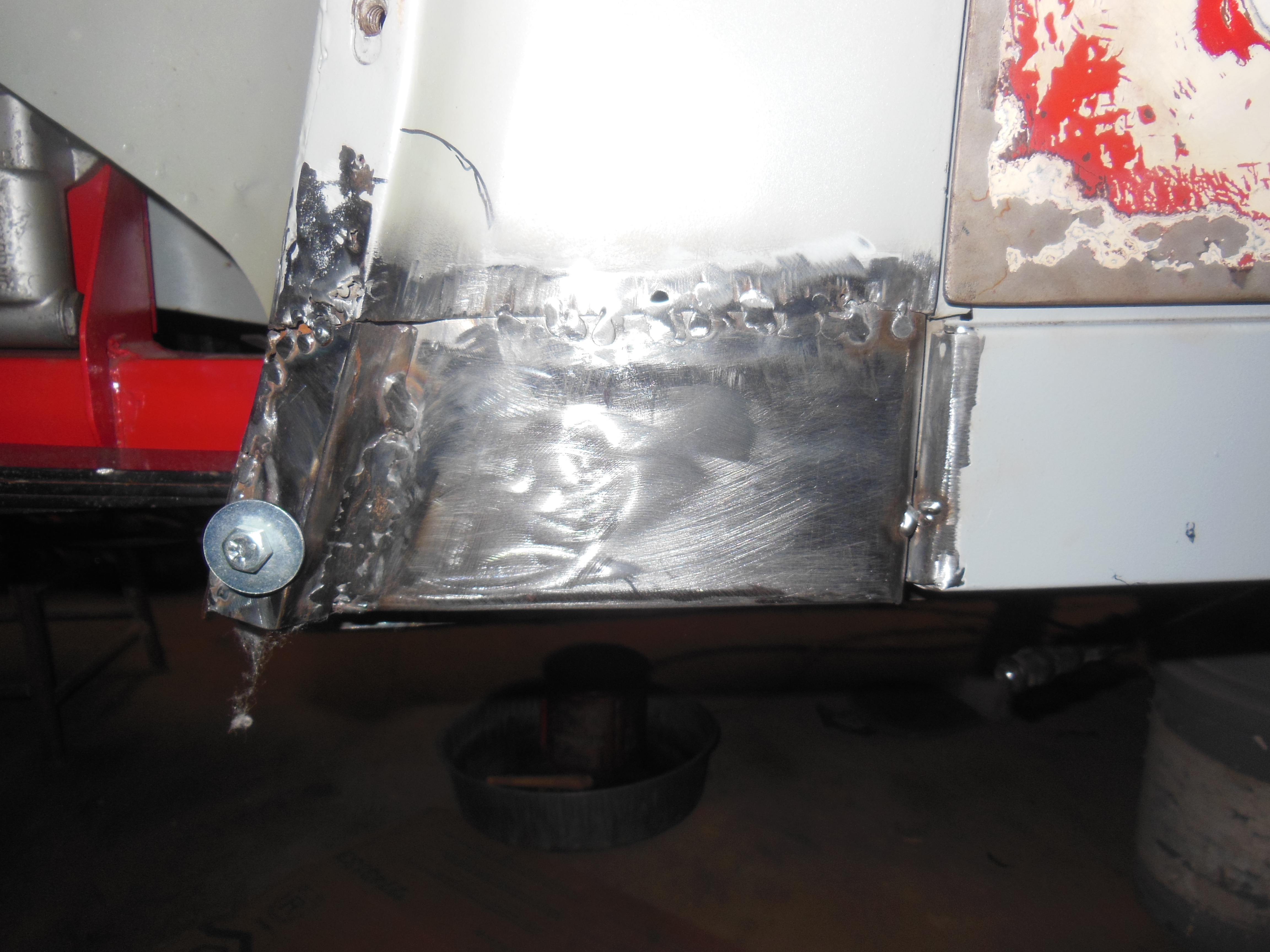

In my heart of hearts I would like to weld something in there. If I use the new sheet metal piece, I am going to try and weld the piece in place.
I like the idea of using the little blue quarter panel piece I have because the curves in the metal would be complete. The piece is mostly rust and leaded in on the outer kick panel side--- which brings in another situation, but I could seam sealer where the 2 pieces meet????. Plus, I would need to do something with the bottom of the piece.
Seems to me the new sheet metal piece would be strongest, and I should be able to add a small piece to fill in the curve without using too much filler.
I really appreciate the input because I am stuck ..... Steve
Once the mig is set on the "right settings" for the metal you are working. You clamp the
part up and weld a spot the size of an eraser ,which you allow to cool for a minute or so
Compressed air can force cool it. Then you do another one.Taking your time is the trick to
a good repair. Even grinding the nubs flat every so often is good as it lets the heat stay evenly
in the panel. It is not absolutly necessary to weld it solid,though most do. In any case filling
over the welds with Tiger Hair rather than bondo is imperative for durability .
Mad dog
Honestly, Steve, if the metal you are dealing with is so thin you are worried about burn through, it will likely rust through within a couple years anyway...whether you weld or glue it together. I had a similar problem with the rear fender just above the trunk floor in my TR2. It was WAY to big of a job to replace the entire fender, and the rest of the fender was pretty decent. In the end I kept blowing through the weld, stopping and increasing the size of my patch...blowing through again...and again! Finally I got a patch large enough that it accounted for the very thin rusted area and I was able to weld it in.

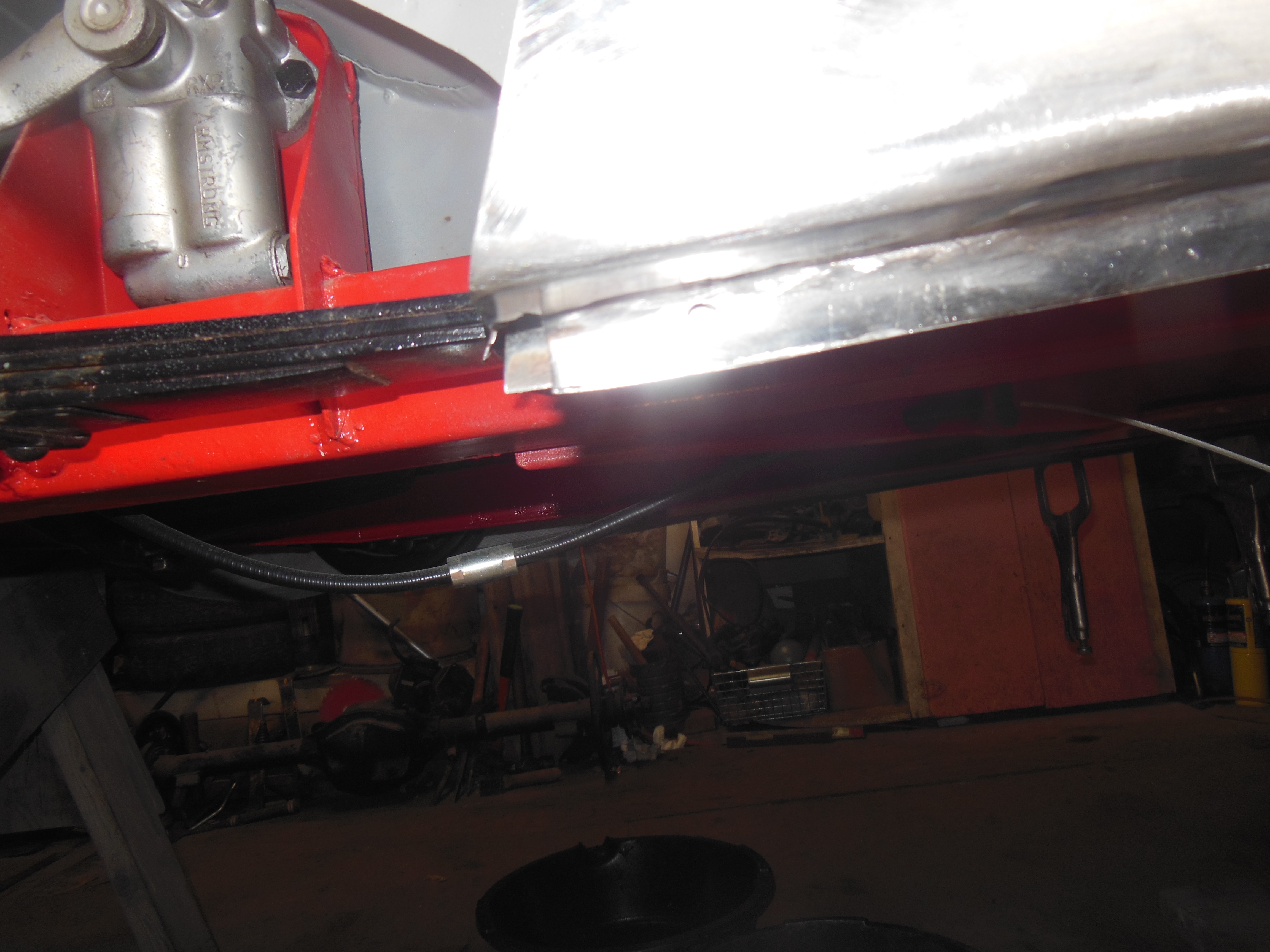

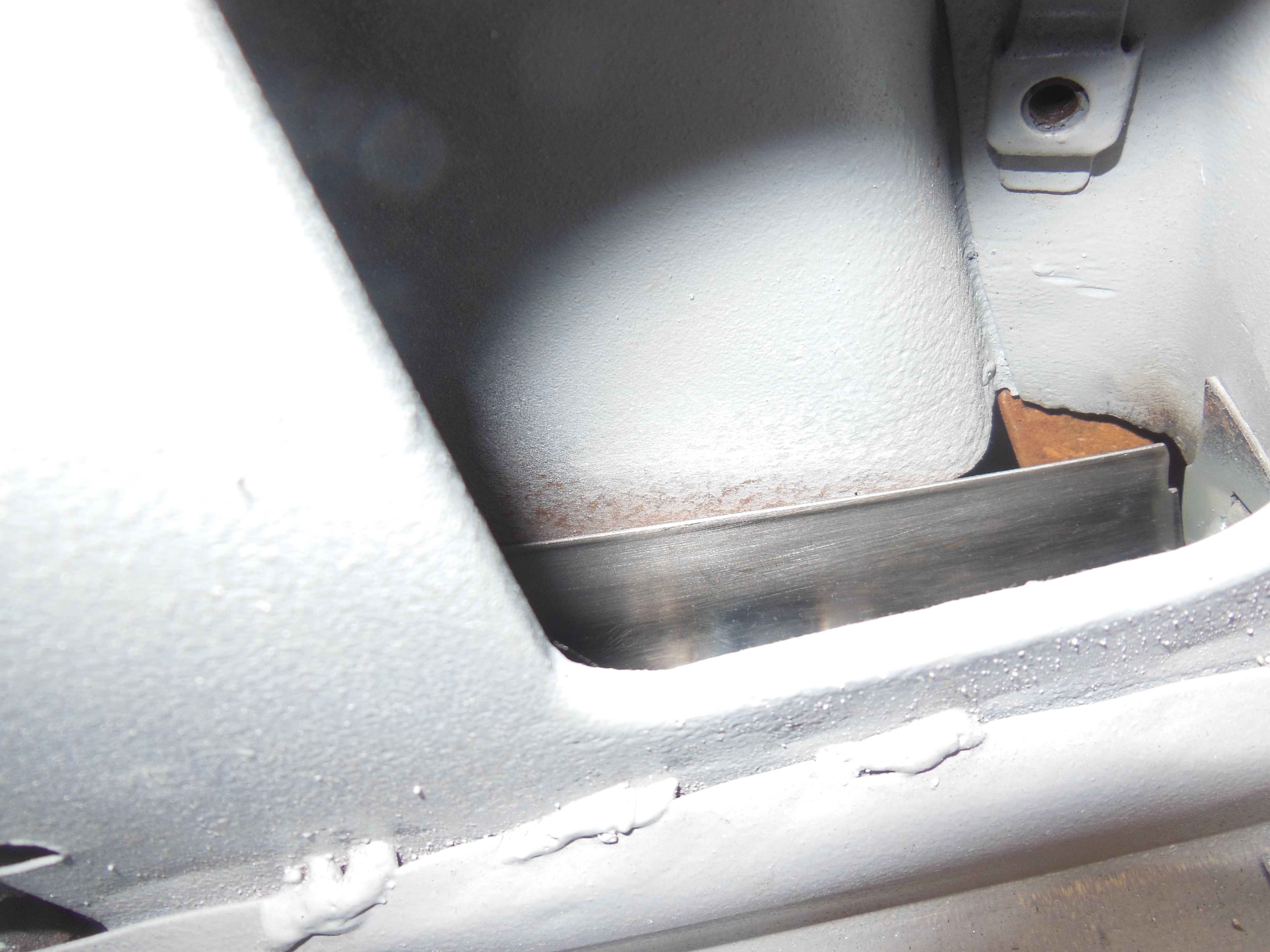

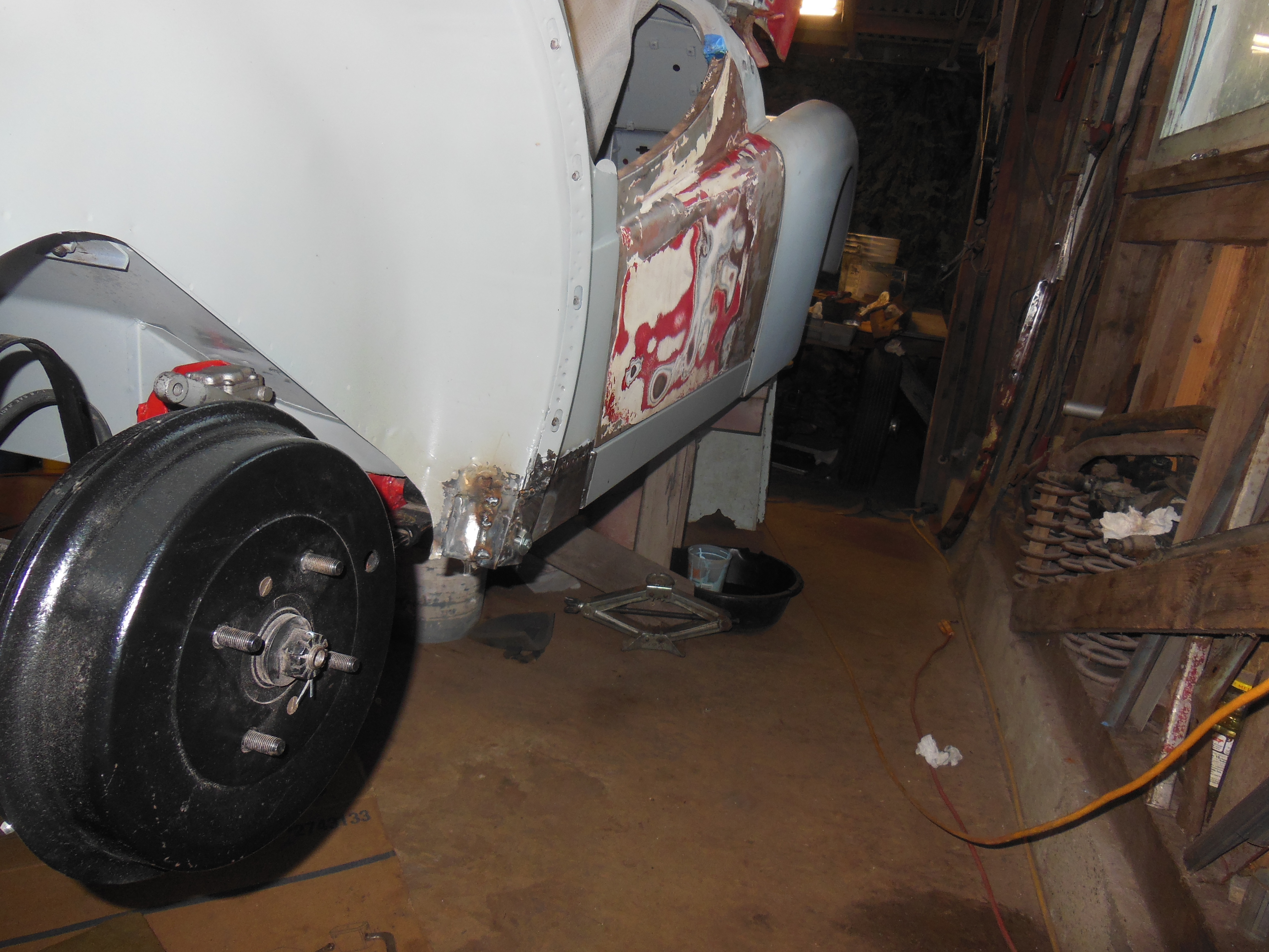

I did weld the pieces in place, but the work does not look very nice.
I replaced the last couple of inches of the inner sill and found that a challenge.
I basically took 2 pieces of flat stock about 16 inches long and 3 inches wide and pushed them through the back of the inner sill on both sides and welded them through the original inner sill allowing the flat stock cantilever out the needed 3 inches and leaving 13 inches inside the sill. Then I trimmed the end and plugged the end with flat stock.
I learned a lot, and I still need to grind the welds.

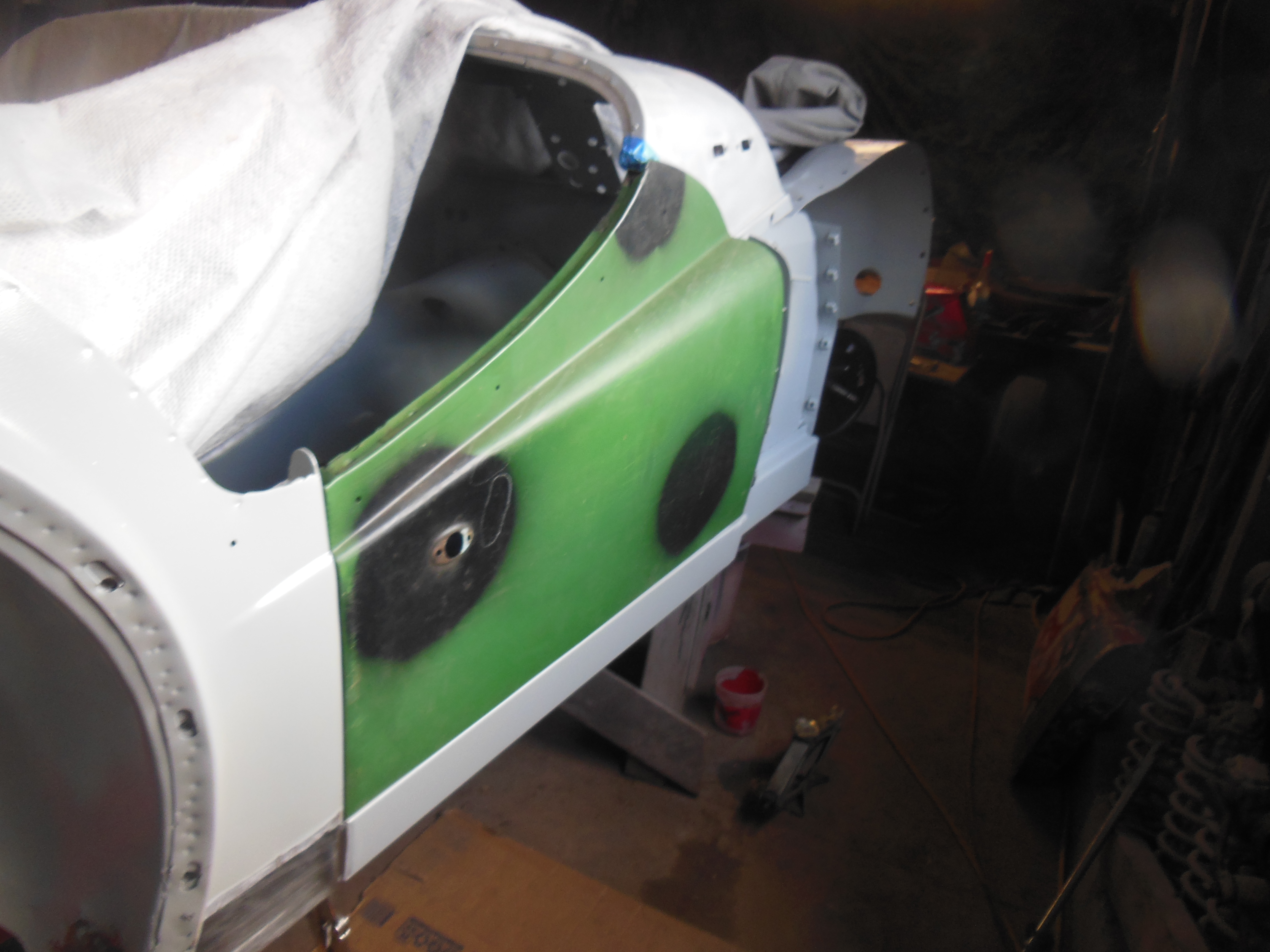

The cool part was I was able to use the tr2 door by going inside the door at the hinges and breaking the gaged nuts loose. The plan worked out better than I thought because the nuts were not weld too good at the factory. If you look inside the door, you can see the cage nuts overlap and are welded together with a tack, but not really welded to the door. I pried the gage open took the nuts out and slotted the holes in the door so the whole door could go inward. The cool part was when I was done I push the cage back over the nuts and you cannot tell. I used those Moss square nuts that are about 1/16 smaller than original and the undersized nut actually worked out better
