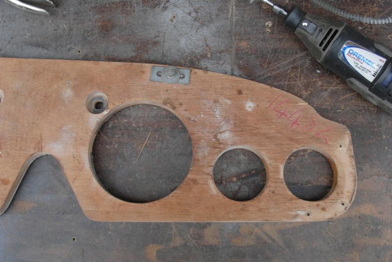

The other interesting find on my dashboard. There is newspaper stuck to the back of it, and numbers written on the back also. The numbers are 27 and 25. Those don't match anything on my Heritage certificate.

Newspaper? Never saw that on the two wooden dashes I worked on. Maybe the guy who worked on the glove box last did the work on the paper so the wife didn't yell at him for working on the dining room table. The numbers were probably to aid in matching the wood grain on the dash. The door pattern/grain should be continuous with the surround.
I also had numbers on the back of the dash and glove box. That was from the factory as I know my car had never been apart since new.
I would bet this car had never been apart. The odometer said 56000 miles. The overdrive and transmission had never been apart. I bought the car in pieces from a lady who had it in her garage for at least 40 years. She bought it for her husband and son to work on together. They never touched it!
