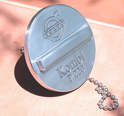

P.S. Iffin ya don't mind lookin at a Girly-man book, I have a Volvo *.pdf diagnostic on these I could send. Heh, speaking of Volvos (attachment)
