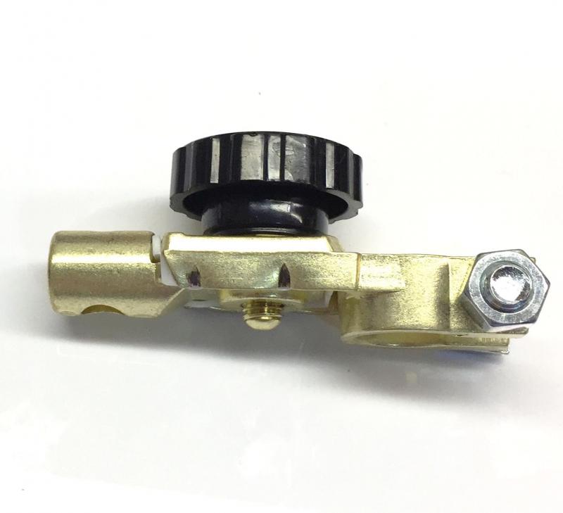

Original (LUCAS?) Cut off Switch is unreliable- This is my opinion After have completely rebuild the oldest one,
https://photos.app.goo.gl/BfbCgY19sWH9Miry8
Not satisfied I have bought one other NEW -
https://photos.app.goo.gl/NfZU3g3SwCccbu9N6
At my first driving tests on a hard corner I have one GHOST engine shut OFF- few second after the energy return ON- Returned at home I bypassed the Origina Cut Off Switch - and put on the battery one simplest Disconnect switch -ENDING all my GHOST problems on my AH
