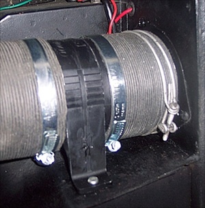

In short, a 4”bilge blower has been installed on the foot well platform forward of where the cold air duct enters the firewall. This 12V fan produces an air stream of up to 240CFM (See next response - Civilizing the blower)

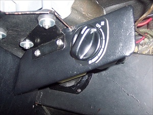

At 240 CFM, the blower must be civilized through the implementation of a speed controller based upon Resistor-Pack (standard heater switch) or, more modern, Pulse-wave Modulation technology. Additionally, the output of the vent must be directed toward the foot well rather than toward the back of the dash. To address these objectives, a deflector was created that included the speed controller and attached via the wiper connectors.

I looked at in-line bilge blowers when I was figuring out how to feed fresh air into my footwells. The two that I tried out had a very loud and high-piched whine. The noise is usually not noticed in a boat as the vent exits through the transom and usually only runs when the motor is running.
How is the noise level on your fan ?

You are correct, when left on high the sound is a little loud (but non-intrusive when under way with the top down) and the blower’s longevity was also at question as the unit was designed to run for short periods at high speed. The speed control was added to address those questions and to provide a further degree of comfort, as a hurricane breeze is not always needed.
This setup has proved very successful, within limits. On a 90+ degree day you are still moving the ambient air into a 100+ foot well for a marginal, but relevant, amount of relief. Again, it is not air-conditioning.

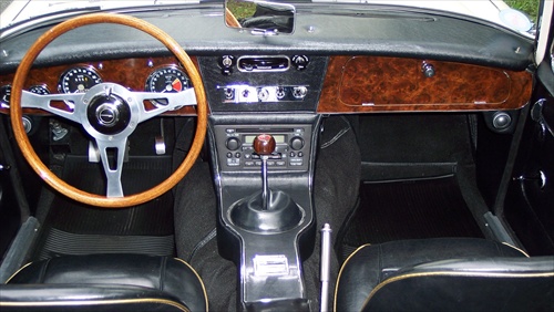

When stating non-BJ8, I am referring to all Healeys except the Mark III. As you can see form the picture below, the BJ8’s tunnel-located console isolates driver and passenger foot wells and eliminates the use of a trans-tunnel fan. Yes, I see no reason why this could be used on other cars.
